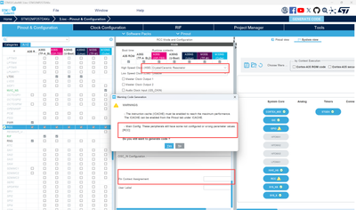

Description of the Issue
I am experiencing a configuration validation warning related to RCC when generating code in STM32CubeMX version 6.15.0 for the STM32MP257DAK3 MPU. Although the code can be generated, CubeMX reports the following RCC warning during validation:
Main Config: These peripherals still have some not configured or wrong parameter values: [RCC]
This warning appears even when the RCC configuration seems complete and valid.
Steps to Reproduce
  1. Open STM32CubeMX v6.15.0
  2. Create a new project for STM32MP257DAK3
  3. Navigate to System Core → RCC
  4. Set HSE to Crystal/Ceramic Resonator
  5. Click GENERATE CODE
  6. CubeMX displays the above warning during pre-generation configuration check

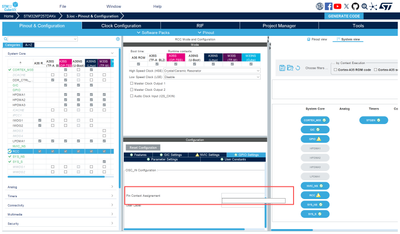

  7. I've selected Pin Context Assignment from the dropdown menu, but it's empty.

Ghofrane GSOURI
Hello @SullyNiu  @Andrew Neil
Your detailed explanation is much appreciated.
The issues have already been identified and escalated to the development team under internal ticket numbers 217338 (for the warning issue) and 216544 (for the Pin Context Assignment issue). They will be resolved as soon as possible.
THX
Ghofrane
