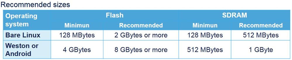

What are the minimum RAM size and FLASH size to run Linux?

For recommended memory size, please have a look to STM32MP1 EXTMEM training https://www.st.com/content/st_com/en/support/learning/stm32-education/stm32-online-training/stm32mp1-online-training.html
