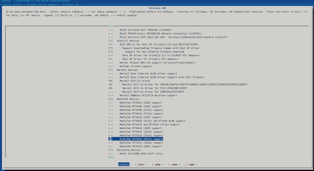

I install the mini PCIe MT7921 wireless network card on stm32mp257f-ev1 board.
root@stm32mp2:/# lspci
00:00.0 PCI bridge: Synopsys, Inc. Device 0550 (rev 01)
01:00.0 Network controller: MEDIATEK Corp. MT7921 802.11ax PCI Express Wireless Network Adapter
The device is normal.configure the kernel and use MT2791(pcie) ,after compilation, update the kernel and modules using the scp command.

Get MT7921 firmware form :
https://github.com/coolpi-george/linuxfirmware/tree/002583713fbcfb167a411c522e9ada1581b85d4c
put into the path /lib/fireware/mediatek. load the corresponding module.
insmod mac80211.ko.
insmod mt76.ko
insmod mt76-connac-lib.ko
insmod mt7921-common.ko
insmod mt7921e.ko
Output the following logs:

[ 1250.940915] mt7921e 0000:01:00.0: hardware init failed
The MT7921 isn't working properly. Please help me analyze the reasons! Thanks a lot!
The firmware of MT7921 is incorrect.repalced with RTL8188EE,it can be used now.
