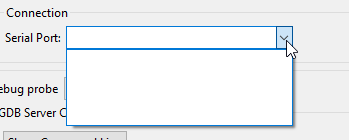

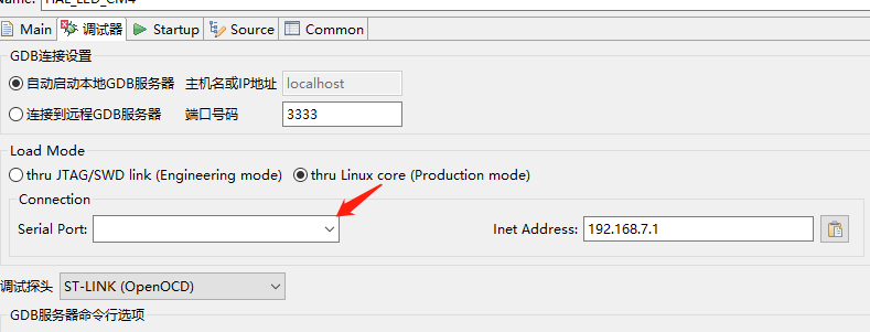

I use cudeide v1.8 in win10 and i debug m4 in load mode thru linux core(production mode). i configure it but i cant find any port when i chose serial port. it is bug?
Xxiao.3
0693W00000HnlIXQAZ.pngand i try use it in ubuntu and it work....so :sad_but_relieved_face:

Kevin HUBER
Hello @Xxiao.3​ ,
This behavior normally happens in Windows 10 if you have a Virtual Machine running that already uses the ports created by the board.
In these case, the ports are invisible for Windows because they are linked to the Virtual Machine.
I tried again on my Win10 and I got the same behavior than you.
If I "Disconnect" the two ports from the virtual machine, Windows can see one of them again:
(You have to close the debug window and open it again).
Hope it helps you,
Regards,
Kevin

Xxiao.3
i turn off vm but it also cant find any serial:dizzy_face: . but cubeide v1.4 is work in win10.

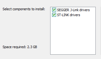

Hi @Xxiao.3​ ,
I just installed other versions of CubeIde on my Windows 10 and it works with CubeIde 1.4 or 1.6 or 1.8.
Please can you uninstall and reinstall the cubeIde 1.8 and be sure that all the drivers are enabled during the setup:
Regards,
Kevin

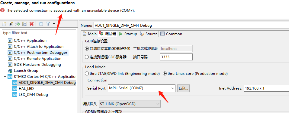

Xxiao.3
0693W00000Hoxx5QAB.pngmy board is make for myself ,157d's debug uart connect CH340. sorry i not use discovery board. but it not work in cubeide v1.8 under win10. but now i can find but it cannot connect. i can use mobaxtrem connect com7 and debug.

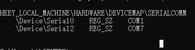

Please can you send me a screenshot of your device manager, the part "Ports (COM & LPT)", like this:
And please open a terminal on windows and use this command:
reg query HKLM\HARDWARE\DEVICEMAP\SERIALCOMM
and send me the traces. This command displays all the serial ports connected to Windows 10 even the one that are used by another application.
Regards,
Kevin
NEW ! Sidekick STM32 AI agent, see here
Xxiao.3
my pc can find com7. i can use com7 debug uboot and kernel. but cudeide v1.8 cant connect it.0693W00000Hp7NHQAZ.png0693W00000Hp7NCQAZ.png0693W00000Hp7NMQAZ.pngi can use the com7 for debug in putty, even if i close putty cude cant connect it.0693W00000Hp7NWQAZ.png
