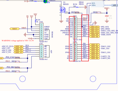

I am new to STM32 architecture and configuration. I am trying to configure new GPIO ports and pins in an STM32H745i-DISCO board. I had some previous code for the pin configuration, but I could not 100% map it to the user manual for the board. The code is the following. I could not match these definitions to any from the manual. Could anyone help me with the mapping for pins D0-D15 on the board? Thank you very much

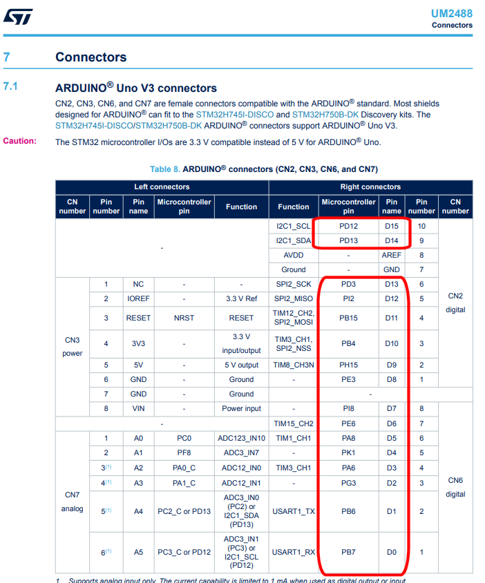

Here they are:
EDIT:
But note that there are two errors in this table - see the posts from @mƎALLEm:
https://community.st.com/t5/stm32cubeide-mpus/cannot-find-a-clear-mapping-from-physical-ports-pins-to-the/m-p/685182/highlight/true#M658

You can find the correspondence D0-D15 / GPIO pins in the board's schematics:
But also in UM2488 / Table 17. STM32H745I-DISCO and STM32H750B-DK I/O assignment: search for ARD_DXX. Example for D3 search for ARD_D3.
So if I understand correctly, PIN D0 is port GPIOB and GPIO_PIN7? Because I tried to use the exact page you shared but lack of experience (first time using STM32) did not make it so clear for me
Hello @kyrkap ,
I think there is a discrepancy between the schematics and Table 8 regarding D0 and D1:
As shown in the schematics I shared in my previous comment:
D0 : GPIOB/pin11, D1: GPIOB/pin10
while in table 8:
D0: GPIOB/pin7, D1: GPIOB/pin6
So try PB11/PB10 for D0 and D1.
Could you please also check other pins D2 - D15?
Yes: "PB7" means "pin (or bit) 7 on GPIO Port B"
But note @mƎALLEm's reply - it seems there might be an error in the table ...
