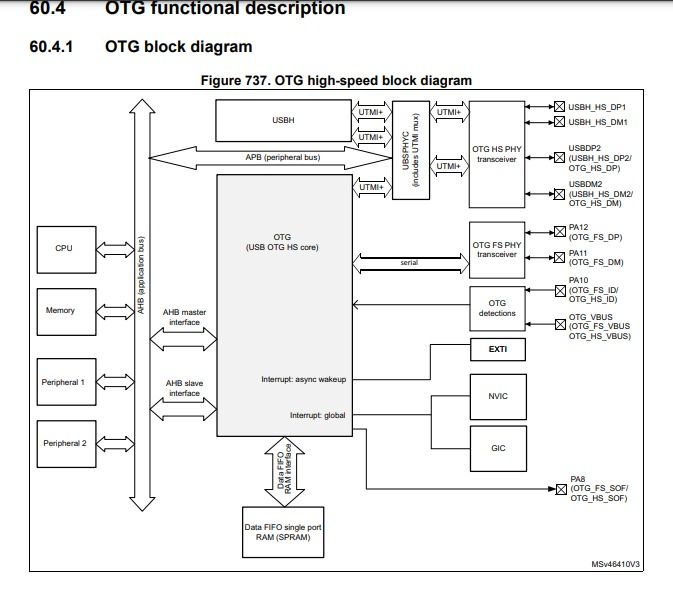

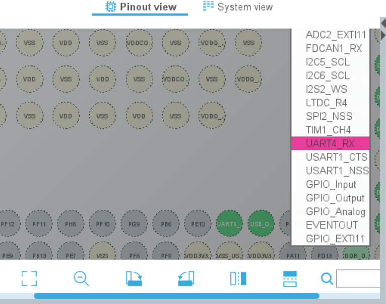

Hey ,
In the OTG block diagram (attached below ) pin PA11 and PA12 can be configured as OTG_FS but using CubeMx we can't set the functionality of these pins.0693W00000D24X5QAJ.jpg0693W00000D24YNQAZ.png

Is there any way to configure these pins?

I confirm this is a limitation of CubeMX, you should leave them untouched in CubeMX and edit manually your Device Tree.
See https://wiki.st.com/stm32mpu/wiki/OTG_device_tree_configuration#DT_configuration_example_as_full-speed_OTG-2C_with_micro-B_connector
and https://wiki.st.com/stm32mpu/wiki/How_to_configure_U-Boot_for_your_board#USB_OTG_node
