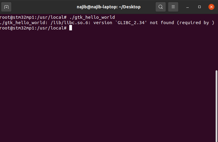

Hello everyone,
I am trying to apply the hello world example from stm32MP1 workshop. everything works fine for me. However, when I try to run the application inside stm32mp1 it shows me this message. version `GLIBC_2.34' not found.
I tried to install newer version of GLIBC but without any suncess.
could you please tell what to do here.

Hi Najib Kassab (Community Member)
Sounds like you are not sourcing the right SDK for your OpenSTLinux version.
What is your original setup (DV version / OpenSTLinux package)?

2022-09-01 5:50 AM
Hi @OlivierK I downloaded wrong SDK for my OpenSTlinux after I download the right one, everything works fine.
thanks for your response.

2023-10-03 6:32 AM
Hi Olivier,
I'm facing the same issue with the gtk_hello_world example. Shows error "version `GLIBC_2.34' not found (required by ./gtk_hello_world)".
How do I know which version of the SDK I need? I simply downloaded the latest version from https://www.st.com/en/embedded-software/stm32mp1dev.html#get-software

Hi @LMarq.4
The SDK you downloaded is the version for the ecosystem 4.1.
Does this version fit your OpenSTLinux version?
