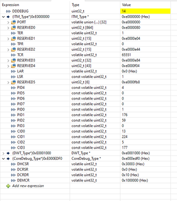

I have a custom-made board with the MP1 (stm32mp157D). The whole board is working fine, the A7 is running Linux and the M4 code runs fine.
But I cannot get SWV to work on the M4 chip.
I have reduced the code to an extremely simple code, nearly 100% generated by CubeIDE - I only added the following lines in the main to increment a counter called DDDEBUG and print using ITM_SendChar() :
/* USER CODE BEGIN 0 */
uint32_t DDDEBUG = 0;
/* USER CODE END 0 */
 * @brief The application entry point.
 * @retval int
int main(void)
  // ... (code generated by CubeIDE) ...
  /* Infinite loop */
  /* USER CODE BEGIN WHILE */
  while (1)
    /* USER CODE END WHILE */
    /* USER CODE BEGIN 3 */
  DDDEBUG++;
  for (char* ptr = "test\n"; *ptr; ptr++)
    ITM_SendChar(*ptr);
  HAL_Delay(1000);
  /* USER CODE END 3 */
The code compiles without errors, and it loads and executes fine, I can see in the debugger the counter incrementing (even in Live Expressions) and the ITM_SendChar function is called correctly.
I also double-checked the PCB design and I can confirm that the TRACESWO / SWO pin is connected correctly to the ST-Link (ST_Link V3 MNIE - an offical ST one, very small without a case). The SWDIO and SWCLK pins are connected and working otherwise the debugging would not work.
The problem is I get absolutely nothing in any of the SWV windows (SWV Data Trace, SWV ITM Data Console, etc.), neither "test" nor can I see the DDDEBUG variable changing. The config is attached and the recording is enabled. I tried both OpenOCD and GDB, they give exact same results (debugging works but not SWV).
Am I missing something here? Is it possible to use SWV at all with an MPU in production mode?
There is very little about SWV for STM32 MPUs, the only article I could find is this one on st wiki and a few topics here which are about engineering mode.
Thank you
Simon

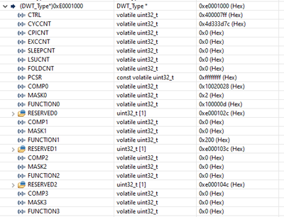

PS: I attached many screenshots of the configuration, including the ITM registers which look correct (but I'm no expert about these). See also the OpenOCD and GDB commands here:
C:\ST\STM32CubeIDE_1.17.0\STM32CubeIDE\plugins\com.st.stm32cube.ide.mcu.externaltools.openocd.win32_2.4.0.202409170845\tools\bin\openocd.exe "-f" "stm32mp157D_DK1_TEST_CM4.cfg" "-s" "C:/Users/Administrator/STM32CubeIDE/workspace_1.17.0/stm32mp157D_DK1_TEST/CM4" "-s" "C:/ST/STM32CubeIDE_1.17.0/STM32CubeIDE/plugins/com.st.stm32cube.ide.mcu.debug.openocd_2.3.0.202411041438/resources/openocd/st_scripts" "-s" "C:/ST/STM32CubeIDE_1.17.0/STM32CubeIDE/plugins/com.st.stm32cube.ide.mpu.debug.openocd_2.2.0.202409171044/resources/openocd/st_scripts" "-c" "gdb_report_data_abort enable" "-c" "gdb_port 3333" "-c" "tcl_port 6666" "-c" "telnet_port 4444"
C:\ST\STM32CubeIDE_1.17.0\STM32CubeIDE\plugins\com.st.stm32cube.ide.mcu.externaltools.stlink-gdb-server.win32_2.2.0.202409170845\tools\bin\ST-LINK_gdbserver.exe -p 61234 -l 1 -d -z 61235 -s -cp C:\ST\STM32CubeIDE_1.17.0\STM32CubeIDE\plugins\com.st.stm32cube.ide.mcu.externaltools.cubeprogrammer.win32_2.2.0.202409170845\tools\bin -m 2 -g
I am using CubeIDE 1.17.0, and the firmware on the ST Link is updated to the newest available. The STM32MP1 firmware package is also the latest.
ITM SWT and CoreDebug Registers:
