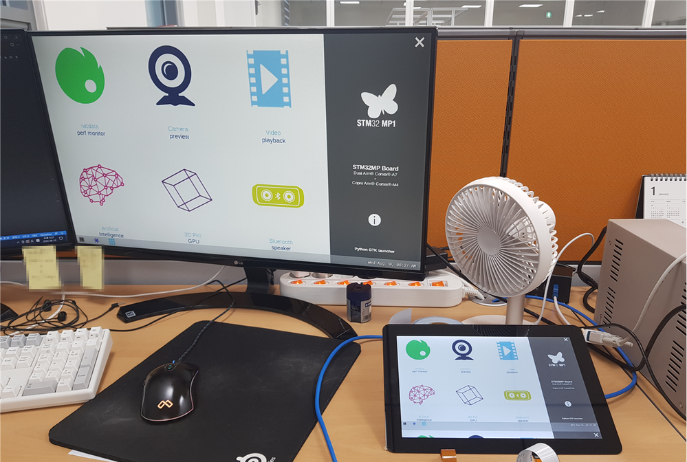

My custom board has RGB(LTDC) and HDMI display interfaces.
We want to display same screen on same time.(duplicate mode)
So, LTDC interface connected to local LCD and HDMI transmitter(sii9022).
&ltdc node of my dts is below ..
&ltdc{
	pinctrl-names = "default", "sleep";
	pinctrl-0 = <&ltdc_pins_mx>;
	pinctrl-1 = <&ltdc_sleep_pins_mx>;
	status = "okay";
	/* USER CODE BEGIN ltdc */
 port {
		#address-cells = <1>;
		#size-cells = <0>;
 ltdc_ep0_out: endpoint@0 {
			reg = <0>;
 remote-endpoint = <&sii9022_in>;
	/* USER CODE END ltdc */
and we can display both screen successfully as below picture.

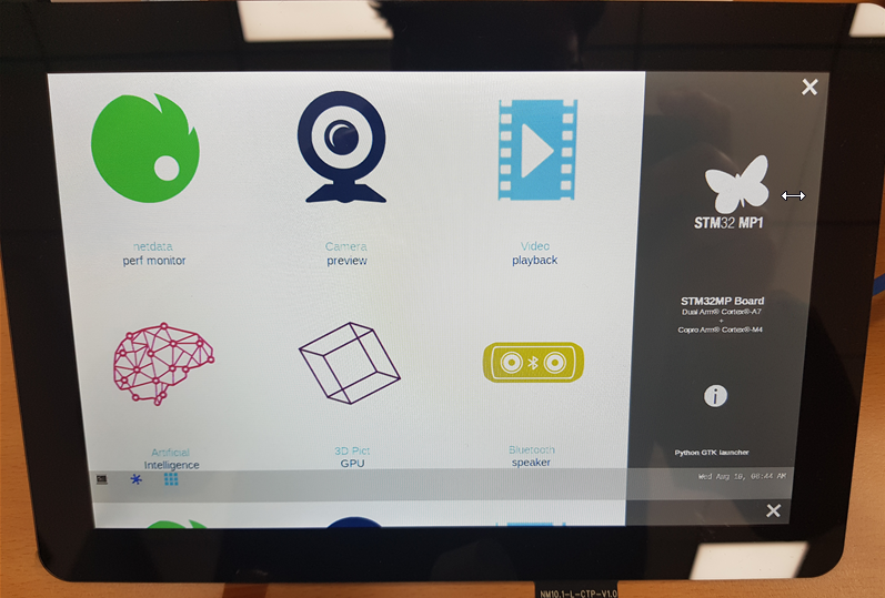

0693W00000QNNNwQAP.pngHowever, unfortunately my LCD`s resolution is 1280x800.
and linux platform doesn't have this HDMI resolution mode.
so my LCD was displayed as below...
0693W00000QNNOQQA5.pngTherefore, I want to add 1280x800 mode to HDMI.
Is there any guide article on wiki?

hochul yoo
August 26, 2022
My clock configuration was problem.
Below linked question was very helpful to me, thanks.
https://community.st.com/s/question/0D50X0000BNscKZSQZ/what-is-the-criteria-for-modetest-to-accept-a-modeline​
