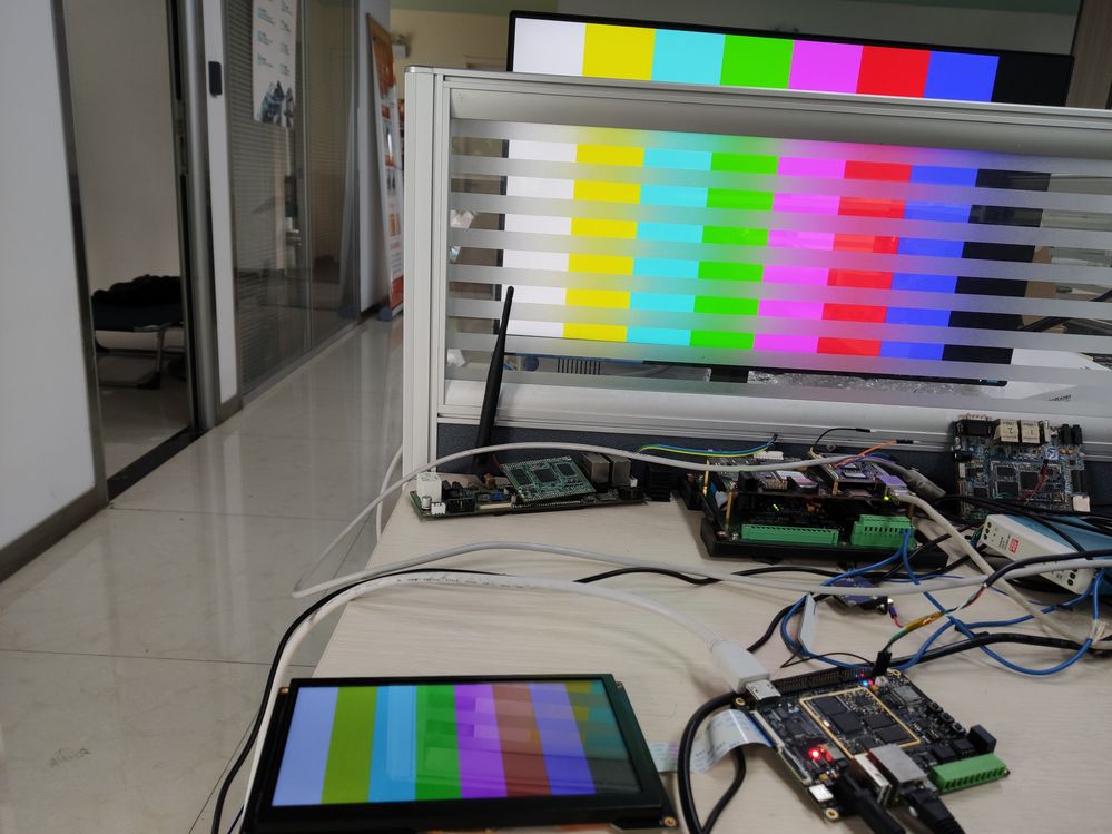

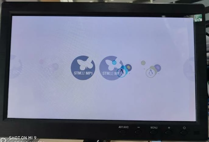

Dear Team,
Currently, we make a progress on mipi dsi display. It does not flicker at 1280x720@60Hz in test pattern mode any more, the pictures are shown below:
Test pattern with horizontal color bar by command devmem2 0x5a000038 w 0x1013f010690X00000AphA1QAJ.jpgTest pattern with vertical color bar by command devmem2 0x5a000038 w 0x13f010690X00000Aph9mQAB.jpg
​But when I disable test pattern by command “devmem2 0x5a000038 w 0x3f01�?, it flicks again. What is the reason for that, do you have some suggestion on this issue?
