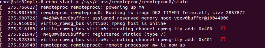

I am trying to replicate the workshop STM32MP1 - 11 Inter-Processor Communication Lab Example. I create a new STM32 project and copy all the data from the lab example. Then I connect the device (STM32MP157C-DK2) but the /dev/ttyRPMSG0 does not initialize (so I can´t send message between processors):
  • My program
  • STM32MP1 - 11 Inter-Processor Communication Lab Example
 0693W00000UolVuQAJ.pngI create my program in STM32CubeIDE version 1.10.1.
How can I initilize ttyRPMSG0 and ttyRPMSG1?
Thanks!

TArre.1
I am using OpenSTLinux 4.0.1 version.
Exactly. I initialize in main.c program (in STM32CubeIDE) the vitual uarts:
  huart0.rvdev = &rvdev;
  print_string("Virtual UART0 OpenAMP-rpmsg channel creation\r\n");
  if (VIRT_UART_Init(&huart0) != VIRT_UART_OK) {
   print_string("VIRT_UART_Init UART0 failed.\r\n");
   while(1){}
  huart1.rvdev = &rvdev;
  print_string("Virtual UART1 OpenAMP-rpmsg channel creation\r\n");
  if (VIRT_UART_Init(&huart1) != VIRT_UART_OK) {
   print_string("VIRT_UART_Init UART1 failed.\r\n");
  while(1){}
Then, I run .elf file on the STM32MP157C-DK2 board but in "/dev/" folder I cannot see ttyRPMSGX.
How can I do it?
Thanks!

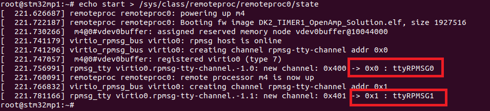

Hello @TArre.1​,
The different steps are explained in the following wiki article: https://wiki.st.com/stm32mpu/wiki/Getting_started/STM32MP1_boards/STM32MP157x-DK2/Develop_on_Arm%C2%AE_Cortex%C2%AE-M4/Modify,_rebuild_and_reload_a_firmware
Note that due to copro architecture, it is mandatory that the A7 cortex send the first message to initialize the communication. In the article example, this is made by the first "Hello Virtual UART0" message.
Kind regards,
Erwan.
Thank you Erwan, I will do the example you sent me to see if I can send messages between processors ;)
