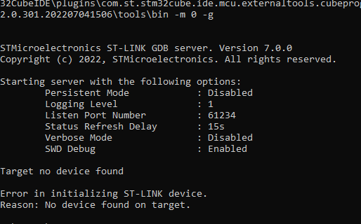

skuma.9
Getting this after running these command:
Could you suggest if I am doing something wrong!!
ArnaudP
The engineering mode is not supported in Zephyr for the stm32mp15 platform. It has been designed to work in production mode, means that the system is initialized by the Cortex-A and the cortex-M is acting as a coprocessor.
If you want to support the engineering mode, you will have first to implement the system_clock config (expecting that is sufficient).
You can have a look to stm32mp1 cube examples for guidance.
https://github.com/STMicroelectronics/STM32CubeMP1/blob/master/Projects/STM32MP157C-DK2/Applications/OpenAMP/OpenAMP_TTY_echo/Src/main.c#L90
This wiki page can also help:
https://wiki.st.com/stm32mpu/wiki/STM32CubeMP1_development_guidelines
