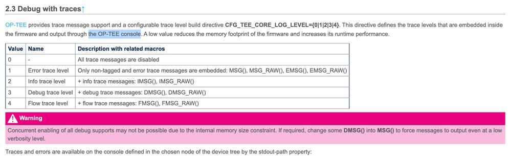

Hi, I want to debug OP-TEE on STM32 MPU board.
Using 'st_stm32mp157f_dk2_demo_defconfig' configuration of STM32MP1 Buildroot external tree(buildroot-external-st), We indirectly confirmed that OP-TEE is built and ran normally on the board with Buildroot.
I would like to customize the code in optee-os using the APIs provided by OP-TEE. Before I do that, I'd like to try to print out whether the code works at a certain point in time and the results of the modified code using the OP-TEE API and track the function calls.
I followed the OP-TEE official document, but the debug log is not captured. In addition, the document only guides you on how to track function calls.
Then, while reading the [How to debug OP-TEE] page on the STM32MP1 Wiki(wiki/How_to_debug_OP-TEE), I realized that the debug log is printed on the OP-TEE console(Marked by the cursor in the attached picture).
So what I'm curious about are two things.
1) Where do the OP-TEE debug results go? (What is an OP-TEE console?)
2) Is there any way to output values inside opted-os? (If not, I wonder if there is a shared memory that can be used between OPTEE and Linux.)

Hi @NKim.3
What we call Optee console is the serial link specified as stdout-path in the Device tree
aliases {
serial0 = &uart4;
serial1 = &usart3;
serial2 = &uart7;
chosen {
stdout-path = "serial0:115200n8";
It's usually Uart4 by default and shared by all BSP component and Linux.
Op-tee trace usually looks like this with [I-D]/TC prefix:
I/TC: Early console on UART#4
Hope it help
Olivier
