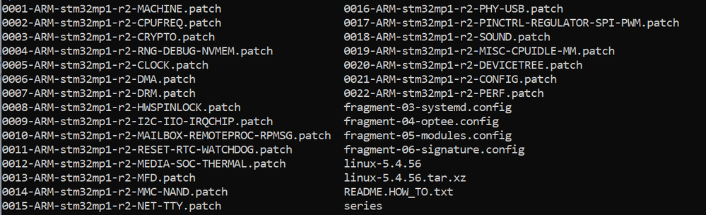

I am working in the following directory which contains patches that I will link in a picture.
Directory :
~/DevPack/stm32mp1-openstlinux-5-4-dunfell-mp1-20-11-12/sources/arm-ostl-linux-gnueabi/linux-stm32mp-5.4.56-r0

2020-12-04 5:16 AM
Hi @SigmaPrime ,
You need to be in subdirectory linux-5.4.56 ( where are located source on which patch applied and call following command :
$>for p in `ls -1 ../*.patch`; do patch -p1 < $p; done
Olivier
2020-12-04 6:10 AM
What an error of mine... I was confused when I read directory to kernel source code.
Works fine thanks
