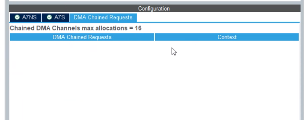

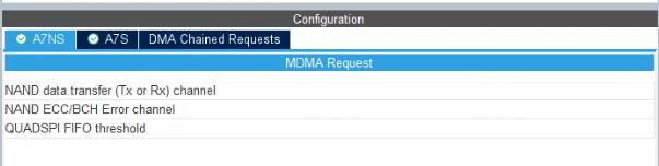

  • MCU SRAM4 (DMA) can be used for other purpose if DMA1 and/or DMA2 is not used in chained mode (using MDMA)

ok, we are using Linux with DMA but I am not sure, if we are using the "chained" mode in combination with MDMA. CubeMX looks like this.
