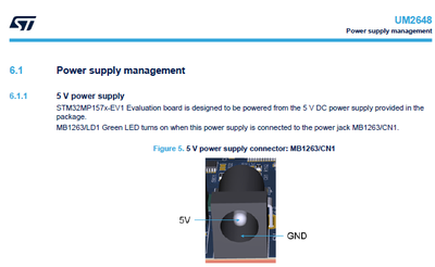

I've lost the power brick for my STM32MP15X-EVAL board. It's a 5v-3a barrel connector, but I don't know the polarity and it's not written on the board or anywhere.
Does anyone know where I can find a replacement, or the exact spec of the power brick so that I can find another one ?

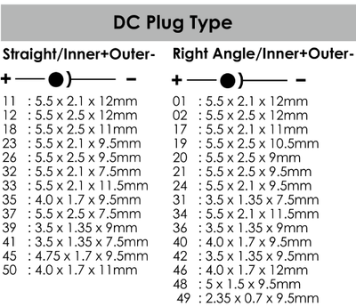

If it helps, the supply I have on my desk is labelled Cincon TRG30R050V-12..., but other suffix might be ok too if plug is still a 5.5 x 2.5mm and at least 9mm long.
https://www.cincon.com/productdownload/TRG30RV-cable-DC-Plug.pdf
Obviously, other supply brand will work if same voltage/current and plug.

As far as I know, evrybody is selling only positive inside, negative outside.
You can pick up any providing 5v +- 0.1V 3A (but 5A gives more room for expansions) is deilvered..

Exactly what I needed. Thanks !
