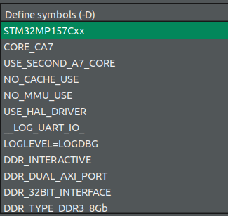

I try to compile ddr tool for M4 but printf not working for some reason.
I have my own custom board with changed UART4 debug ports and I2C4 different ports.
So I changed ports and pmic is configured well UART4 also but I see on the console only "DDR>" and I can provide some text like "step 3" but not see anything like DDR> and my texts. Of course, I assigned buttons and LEDs which seem to work
Reworking this firmware is a difficult task.
The preprocessor definition I used are
_legacyfs_online_stmicro_images_0693W00000biQwbQAE.pngHow to force to see printf
  • After the step above lines I see nothing in my uart terminal console why?
