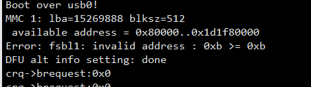

I designed a PCB using LPDDR3 and STM32MP157AAA3 MPU, but I accidentally found that u does not support, this is not a pit man? Why is this diagram on the DDR instruction manual AN5122, I'm designing it accordingto this. But now pcb has produced how to solve this problem?

Good news! I have successfully used LPDDR3 on STM32MP157AA3.:beaming_face_with_smiling_eyes:
0690X00000Arm50QAB.pngbut,when i use emmc ,the error at fsbl1 ,i don't kown the mean:loudly_crying_face:
Could you please copy the full trace log ?
