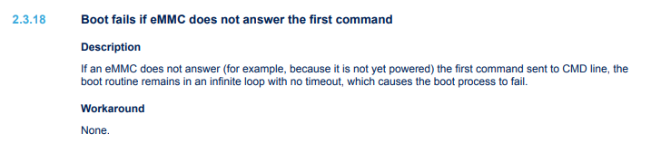

Referred ES0438 regarding eMMC boot failure. Can you please confirm below eMMC boot failure issue also fixed on Rev.Z?
Regards,
Ganapathi
PatrickF
Yes, this one also is corrected.

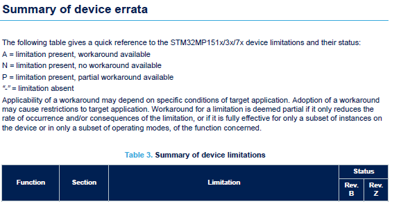

All information about limitation presence on each revision are in ES0438 Table 3
Regards,
