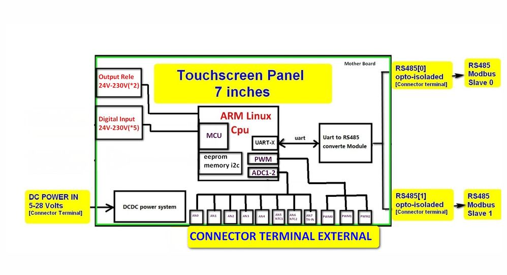

ADC1+ADC2  - Analog Multi channel IO
DEVICE TREE

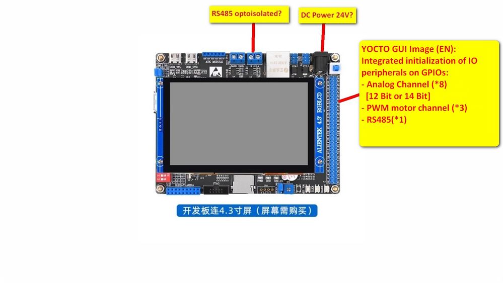

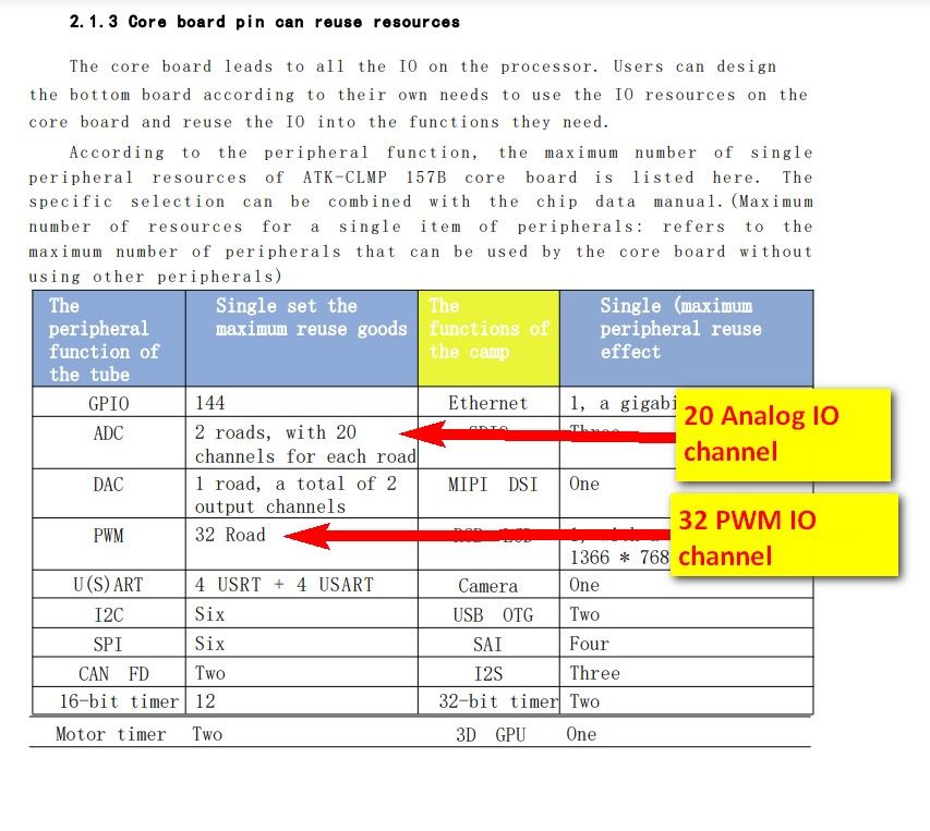

It is essential to create from device tree :
- 8 ANALOG type GPIO physical pins on the board (AN0,AN1,AN2, AN3,AN4,AN5,AN6,AN7)
- 3 GPIO physical pins of PWM type real time motors on the board (PWM0, PWM1,PWM3)

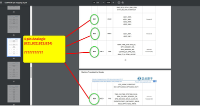

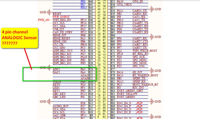

But manufacturing company says only 2 ADC pins can be read,
I attach STM32MP157 MINI mapping:
STM32MP157DAA1_1G-RAM _ 8GB-eMMC - Datasheet
But the powerful SOM BOARD STM32MP157DAA1_1G-RAM _ 8GB-eMMC clearly specifies 22 multiple IO Analog channels on ADC1 and ADC2 and 32 multiple PWM IO channelsADC_PWM_channel.jpg
Please multiple control of 8 analog sensors and 3 PWM sensors (motor control) in Linux is fundamental for my machine control project from Linux CPU, that's why I chose the powerful STM32MP157 MINI board from alintek (STM32MP157DAA1_1G-RAM _ 8GB-eMMC)
Your precious help is essential, thanks

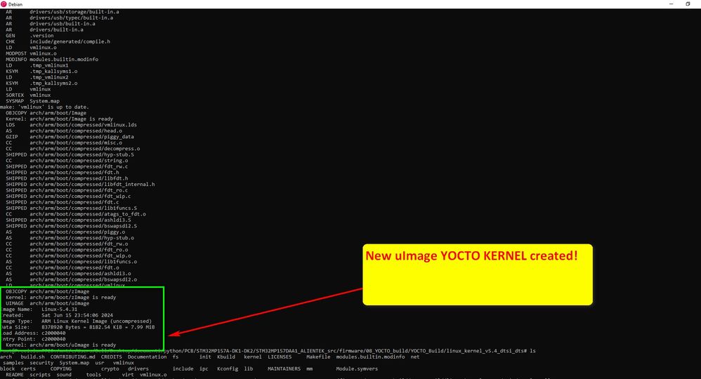

A first uImage KERNEL Linux YOCTO STM32MP157 board image has been generated, it is only a first generation test but the cross compiler did not throw errors:
this guide was fundamental (Chinese, right click automatically translate from Browser please):
https://www.bilibili.com/read/cv11484220/
Now what needs to be done:
1) uImage (local pc):
uImage should be loaded on the File System of the STM32MP157 board in /boot or in which path??

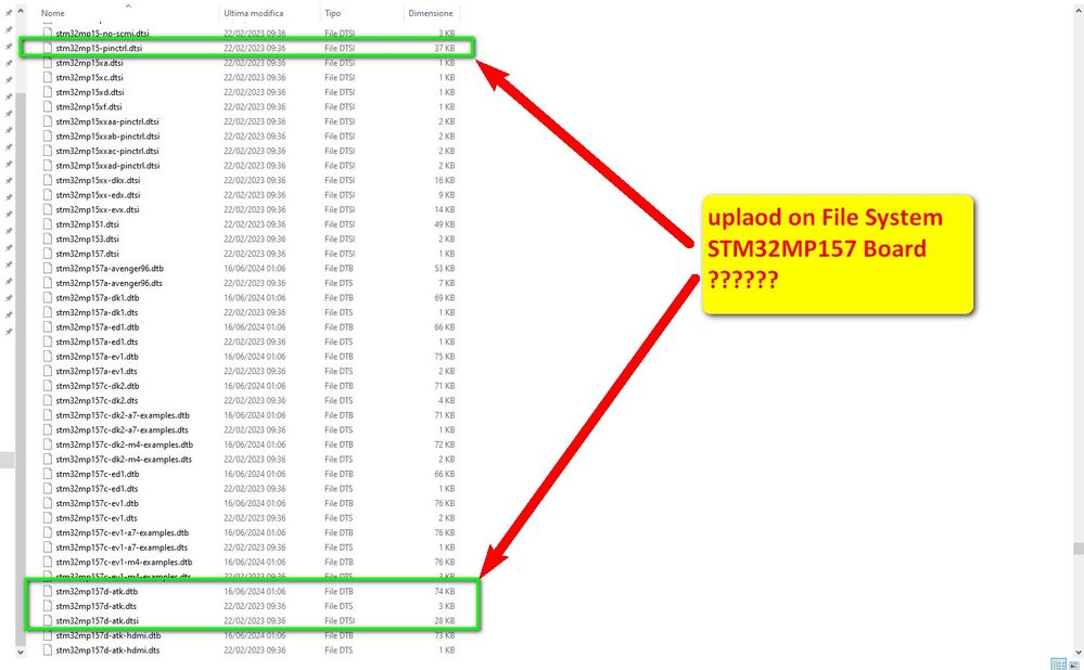

2) DEVICE TREE FILES MODIFIED (local pc)
NOTE: I remember the modified device tree files are the following (see ADC MULTIPLEXING manual EN on page 52:
- stm32mp15-pinctrl.dtsi
- stm32mp157d-atk.dtsi
Which device tree files should be loaded onto the File System of the STM32MP157 motherboard and where should they be loaded in which path??:
- stm32mp157d-atk-hdmi.dtb (???)
- stm32mp157d-atk-hdmi.dts (???)
- stm32mp15-pinctrl.dtsi (???)

Hi @bass34
I'm not expert and not knowledgeable on the board you are using, I will try to help you on that topics:
1) please have a look to https://wiki.st.com/stm32mpu/wiki/OpenSTLinux_directory_structure
2) please have a look to https://wiki.st.com/stm32mpu/wiki/STM32_MPU_device_tree
3) those should help:
https://wiki.st.com/stm32mpu/wiki/ADC_OpenSTLinux_drivers#Linux_kernel_driver
https://wiki.st.com/stm32mpu/wiki/How_to_use_the_IIO_user_space_interface#How_to_do_a_simple_ADC_conversion_using_the_sysfs_interface
4) I did not fully understand your concern, with Yocto and embedded Linux systems, you should (and you must) generate a customized full image of all the eMMC partitions (in order to being able in production to flash blank boards using STM32CubeProg or else), so backup is not a concern as eMMC image is already on your PC.
Regards.
