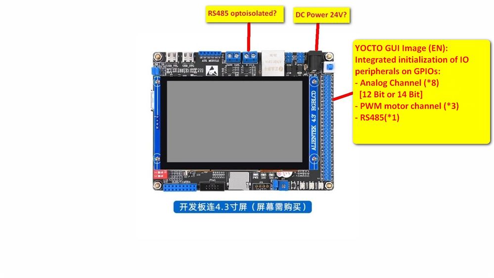

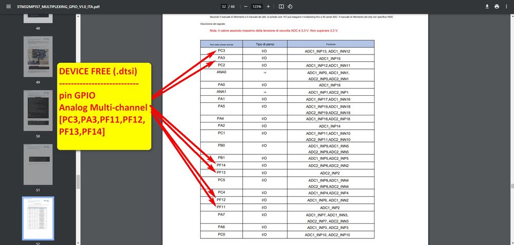

It is essential to create from device tree :
- 8 ANALOG type GPIO physical pins on the board (AN0,AN1,AN2, AN3,AN4,AN5,AN6,AN7)
- 3 GPIO physical pins of PWM type real time motors on the board (PWM0, PWM1,PWM3)
But manufacturing company says only 2 ADC pins can be read,
I attach STM32MP157 MINI mapping:

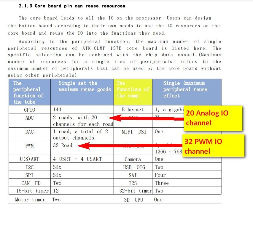

STM32MP157DAA1_1G-RAM _ 8GB-eMMC - Datasheet
But the powerful SOM BOARD STM32MP157DAA1_1G-RAM _ 8GB-eMMC clearly specifies 22 multiple IO Analog channels on ADC1 and ADC2 and 32 multiple PWM IO channelsADC_PWM_channel.jpg
Please multiple control of 8 analog sensors and 3 PWM sensors (motor control) in Linux is fundamental for my machine control project from Linux CPU, that's why I chose the powerful STM32MP157 MINI board from alintek (STM32MP157DAA1_1G-RAM _ 8GB-eMMC)

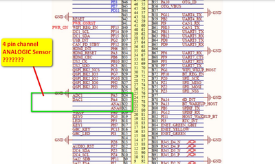

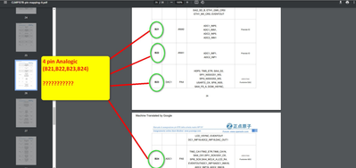

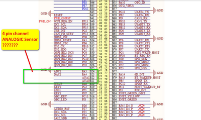

thanks Patrick but I'm very angry,
the manufacturer responded Alientek simply by sending the pin mapping of the motherboard saying that only 2 GPIO PINS can be used to read channels and therefore only 2 analog sensors B23 e B24:
while their data sheet of their assembled SOM CORE Board STM32MP157DAA1_1G-RAM _ 8GB-eMM clearly talks about ADC1 and ADC2 on which up to 22 analog channels can run, I am very angry now and confused:

Is it possible to indicate here a ready-made YOCTO STM32MP157 factory linux image?                                              Device tree already integrated with multi analog pin GPIO and multi PWM pin GPIO real time motor control?

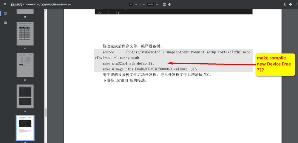

The manual for MULTIPLEXING GPIO pins has arrived and I attach it here on topic,
but it is not clear how to create a new .tsv file of the new firmware
1) after modifying the dtsi files of the KERNEL source device tree (mapping of the new 6 GPIO pins as Analog INPUT) how to create a new firmware .tsv file?
Should these 3 commands for compiling the new device tree be executed via ssh directly on the file system of the STM32MP157 MINI board?
1)source /opt/st/stm32mp1/3.1-snapshot/environment-setup-cortexa7t2hf-neonvfpv4-ostl-linux-gnueabi
2) make stm32mp1_atk_defconfig
3) make uImage dtbs LOADADDR=0XC2000040 vmlinux -j16

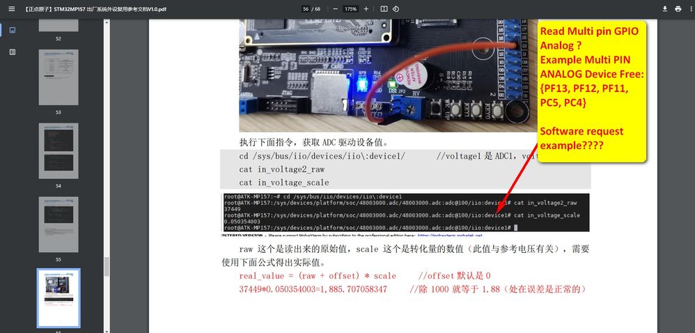

2) The software to read the analog voltage on a specific GPIO PIN as per the MULTIPLEXING manual on page 56 is performed by calling together device 1 (entire ADC1 voltage) and device 2 (entire ADC2 voltage), but in the case of 6 pins GPIO separated and configured on ADC1 and ADC2 how do you read the analog voltage on the individual GPIO pins separately and independently:

Regarding ADC, please have a look to
https://wiki.st.com/stm32mpu/wiki/ADC_device_tree_configuration
https://wiki.st.com/stm32mpu/wiki/ADC_OpenSTLinux_drivers#Linux_kernel_driver
https://wiki.st.com/stm32mpu/wiki/How_to_use_the_IIO_user_space_interface#How_to_do_a_simple_ADC_conversion_using_the_sysfs_interface

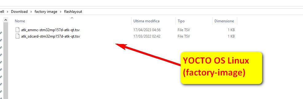

Hi Patrick
Thank you,
The YOCTO factory image of the STM32MP157 is a .tsv:
The MULTIPLEXING STM32MP157 MINI powerful board manual says that after editing the .dtsi files:
"Once you have completed editing the files, save the file and compile the device tree by indicating these commands MAKE Compile":
1) but where should they be launched on the STM32MP157 MINI board or on the compiler PC?
2) how to create a new .tsv file with compiled analog GPIO multi pins?
