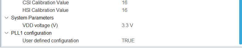

I'm trying to configure a CubeMX project, starting from scratch, for a custom board based on a STM32MP153CAC3.

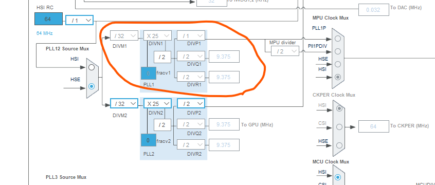

And I'm having an issue with the MPU clock setting. In particular, I can't select any MPU Clock Mux option and see the PLL1 tree as not editable:
Is it normal? Do I have to change something to unlock the configuration? It seems very strange to me that I can't change the MPU clock!
NOTE: used CubeMX v6.9 and v6.11, standalone version, same result.
Please help me :)

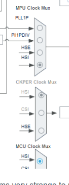

as long, as you dont use any of its outputs...it shows "unused" = grey.
on bottom MCU mux (blue) something is used...

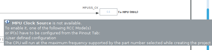

But now I'm asking myself (and you), what's the meaning of that clock (MPUSS_CK)? Isn't the main core frequency? If it's not, how can I set the frequency of the MPU (if there's a way to do that)?
Thanks
Dont know - (as i dont have any MPU :) ) - but yes MPU and MCU ckls should be the core clocks...
see ds/rm :
For the "grayed" muxes -> just hover on it with mouse pointer - and wait , it shows you text : why...and what to do !

Hi @AScha.3 ,
Mh interesting, looks like that... well, it seems I don't have to do anything to run at maximum speed by default.
That's ok, I think.
Thanks a lot for your time!!
See ya
EDIT: Found it!
Was pretty hidden :)
