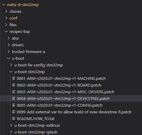

this wat i have in my Yocto layers: 0693W000004IFQBQA4.jpg
do i need to update the layers from git source?
Olivier GALLIEN
Hi @SMich.1​
In order to integrate the u-boot hot-fix in Github in your Ditribution environnement please refer to instruction here :
https://wiki.st.com/stm32mpu/wiki/STM32MP15_OpenSTLinux_release_note#Minor_release_updates
