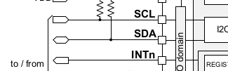

Greadt find. My board uses legacy, regulator power. No PMIC. I had to remove all PMIC related power from the DTs and create new DTs for  regulator power.  The PMIC (likely STPMIC1) uses I2C and perhaps it also uses and interrupt to the MP .and perhaps the kernel did not enable the power to EMMC ?. Just a guess..
