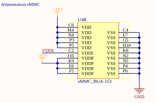

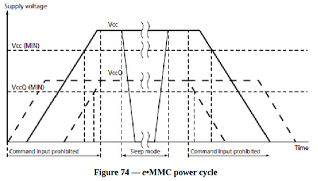

Thanks for your explanation,
I have read the MB1263 eMMC shematic. The Vcc is connected to V3v3/Buck4, and Vccq to Vdd/Buck4. Since the latter is masked to avoid power cycles, only the Vcc is powered-down during NRST toggling. According to the JEDEC power cycling standard, this puts the eMMC to the pre-idle state:
"If VCC or VCCQ are below 0.5 V for longer than 1 ms, the slave shall always return to the pre-idle state, and
perform the appropriate boot behavior, as appropriate."
Screenshot 2024-12-11 at 14-53-28 eMMC4.5 - toaz.info-jesd84-b51-pr_cb38ab6d8afd8884fa88debd9734f986.pdf.png
But in our custom board, the Vcc and Vccq is connected to V3v3/Buck4:
Thus, on power cycling Vcc and Vccq are powered-down. Vcc and Vccq shoud not use the same supply and only Vcc should be powered-down from my understanding. This seems to be the reason why our eMMC does not return to the pre-idle state ?
Enable eMMC RSTn is the solution, but I want to know the root cause of our reboot problem.
Regards,
Maybe when both VCCQ and VCC are shutdown, the time for the eMMC to 'restart' is longer and does not accept the first CMD0 command sent few tens of ms after power-up.
If this is the root cause, I see two options:
Reprogramming STPMIC1 NVM to have buck4 in rank1 (it is rank3 by default) might give slightly more time (+3ms).
Increasing NRST capacitor could also help a bit for few ms (e.g. from 10nF to 100nF).
Regards.

I thought the same thing.
I think the best solution is to change the Vccq power supply to Vdd/Buck4 for our next board revision. At this time, enabling eMMC RSTn is a workaround.
Thanks a lot for your help,
Regards
I think you talk about eMMC Vccq tied to MP15 VDD/Buck3 (as on MB1263).
Tip of the day: Try Sidekick STM32 AI agent, see here
Yes, I just inverted. Vccq => Vdd/Buck3, and Vcc => V3v3/Buck4.
