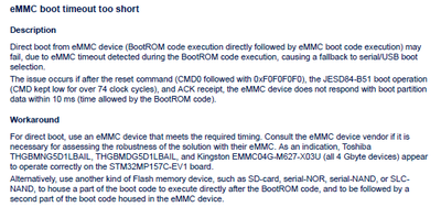

May you check the version of your silicon ?
Rev.B (REV_ID = 0x2000) have some issues with many eMMC (Rev.B has bee produced in early days few years ago, but maybe some distri have still some old parts in stock).
all that are solved on Rev.Z (REV_ID = 0x2001).
Revision is mention on the package or usually listed during boot.
Please refer to ES0438 document.
Regards.

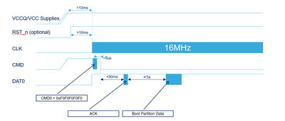

BootROM do the following:
- CMD0 + 0xF0F0F0F0F0 (GO_PRE_IDLE_STATE). Which as JEDEC states, should be equivalent to an HW reset. RSTn should normally not being required (bit maybe some eMMC behave differently)
- Then uses 'CMD low' mechanism to get the boot sector.
something like this
Regards
Tip of the day: Try Sidekick STM32 AI agent, see here

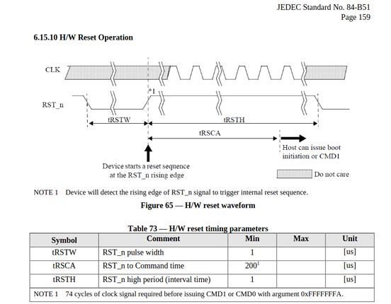

Thanks for your answer, I want to know what I am doing to avoid side effects.
So, if I understand your graph correctly, an RST_n signal occurs at boot time, but not initiated by the ROM code ?
As you said, maybe it is optional but required for our eMMC to be in pre-idle state to be used as a boot device. The HW reset chapter of the sandisk eMMC documentation just refers to the JEDEC spec :
And I read in the TI forum :
"The reason is when you use eMMC in your system it is most likely your boot device, hence you want maximum reliability for this device to be ready and in working order during every boot. This implies that you probably want hardware to control the eMMC reset signal in some way".
I cannot test on the avenger96 since the SoC Rev.B cannot boot on eMMC due to timeout issue, but I think the RST pin needs to be enabled for this eMMC.
