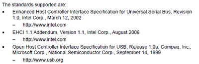

i'm writing a program to run on STM32MP135F-DK board that enable the USB host ports of the board.
All the projects I've found are using the OTG port as host.
All the HAL_HCD apis and xxx_ll_usb source use the OTG structures.
Is there ant sample for USB HOST ports?
I only found the macros:
#define USB1HSFSP2_BASE (AHB6_PERIPH_BASE + 0xC000UL)
#define USB1HSFSP1_BASE (AHB6_PERIPH_BASE + 0xD000UL)
#define USB1_EHCI ((USB_EHCI_CapabilityTypeDef *) USB1HSFSP1_BASE)
that's ok .. but what about all the other USB (EHCI/OHCI) registers described in the manual?
Thanks!

We do not support USB HOST in our Bare metal solution.

USBH IP use EHCI/OHCI standard registers view and capabilities descriptions (then IP mostly use descriptors located in RAM). Maybe a clue to find existing code available on other similar implementations (but I fear EHCI/OHCI was intended mainly for rich OS like Linux or Windows).
If I understand well, you will focus on USB full-speed only, so, OHCI might be sufficient.
