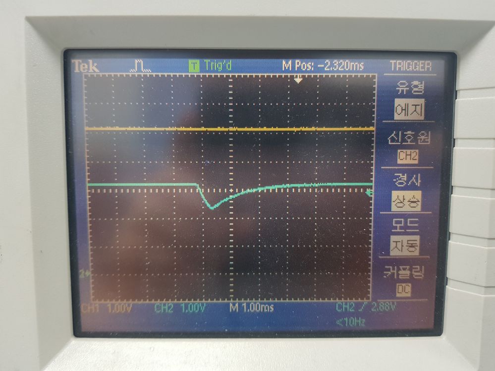

STPMIC1A BUCK4's default output level is 3.3V and eMMC use it for VCC.
In some boards without any problem, BUCK4 output 3.3V normally.

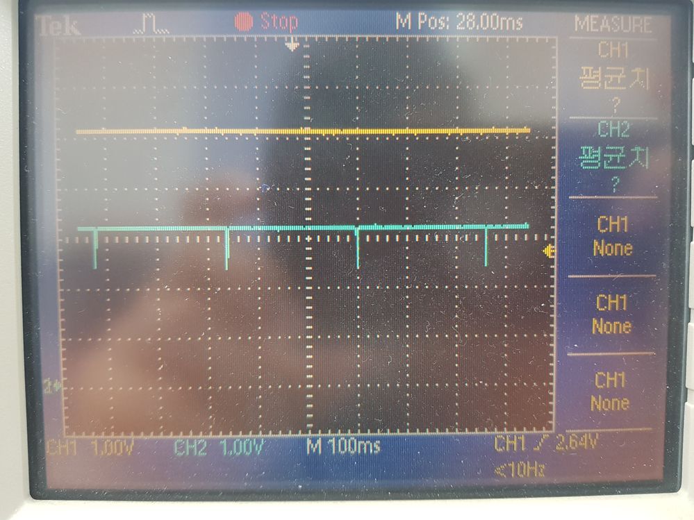

In some boards with the problem, BUCK4 output 3.17V abnormally.
Plus, it looks like as following with a cycle time of about 250ms,
As a result, the board fails to boot.
Yellow is 5VIN and Blue is BUCK4 output.

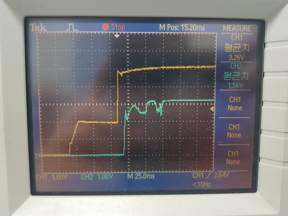

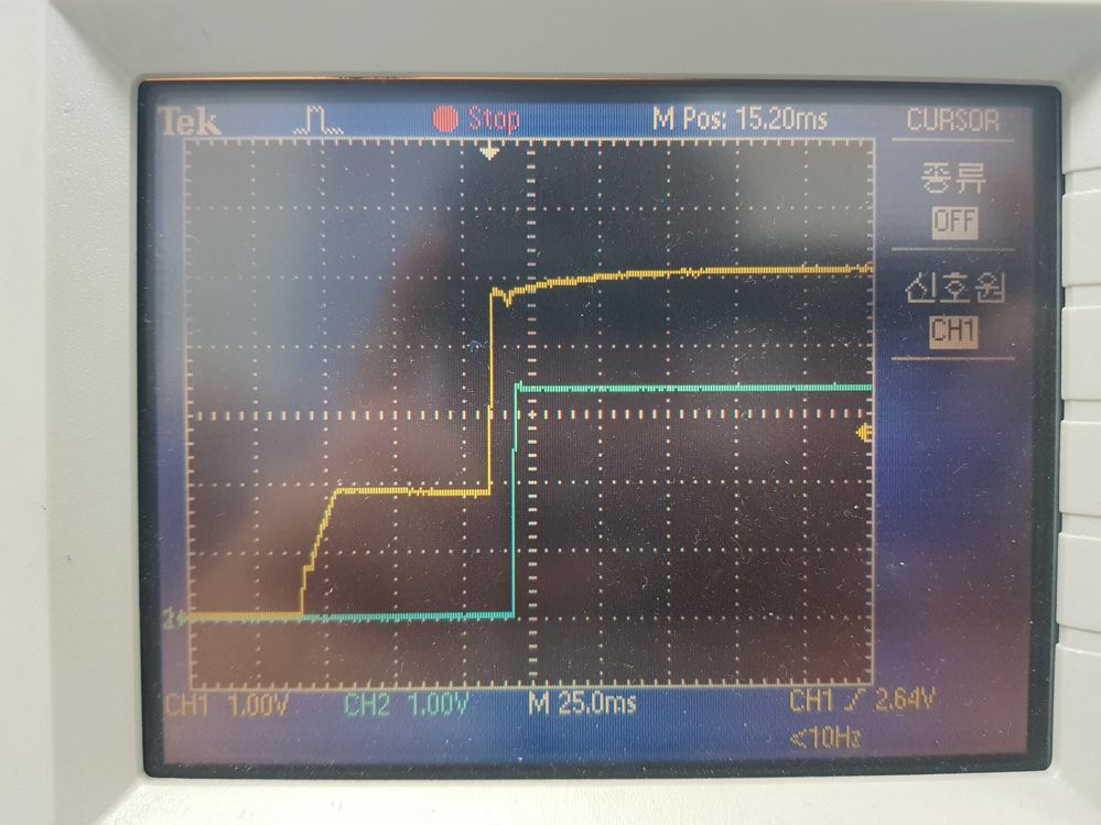

3) VIN Threshold
The first is a picture of a normal board and
the second is a picture of an abnormal board.

look like Buck4 is not running properly or overloaded.
Did you use recommended STPMIC1 components (from STPMIC1 datasheet) and recommended layout (from AN5431) ?
Did you excluded manufacturing issues like bad soldering on STPMIC1 and surrounding components ?
Particularly, check correct soldering of STPMIC1 EPGND (which is sometimes hard to get correct soldering due to large area and high thermal conductivity to inner layers)
Did you check for some board shortcircuit which could make Buck4 overcurrent limitation to occur.

Hi @hochul yoo,
could you check the C99 input cap of Buck4IN and check the PCB layout especially for the connection of the feedback input for Buck4 (Vout_4 pin #27), it must be connected with dedicated track directly on the cross of the inductor and Cout passive components for a good control of the buck converter.
Let me know
