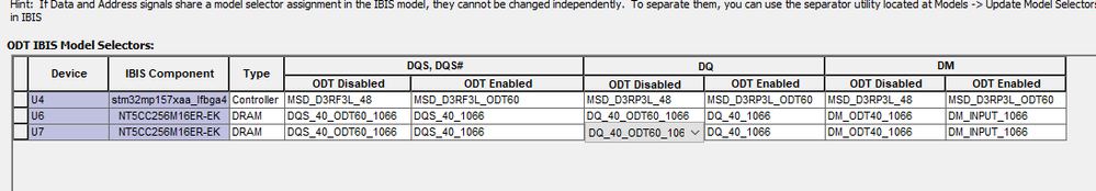

Hi everyone,
I have tried to check eval board PCB with hyperlynx DDR wizard but I can't.
I downloaded all of the IBIS data which are Nanya DDR3L ram and MP157A.
However, I'm confused about which ODT models I should choose.
Please help me which model I chose to pass this check.
By the way, I attached the odt model page screen.

PatrickF
With a DDR3L you can set the values below for your simulation:
In write mode (ODT disabled on STM32MP1 side, ODT enabled on memory side)
  • Controller (STM32MP1) model are :
    • DQ and DM are MSD_D3RP3L_48
    • DQS is MSD_D3RF3L_48
    • CLK is defined PDDRIO_PAD, select MSD_D3RP3L_48
    • address and control are MSD_D3RP3L_48
  • DDR model is set with ODT 60 and frequency 1066.
In read mode (ODT enabled on STM32MP1 side, disabled on memory side)
    • DQ and DM are MSD_D3RP3L_ODT60
    • DQS is MSD_D3RF3L_ODT60
  • DDR model is set with Zout 40 ohm and frequency 1066

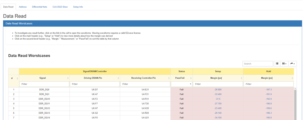

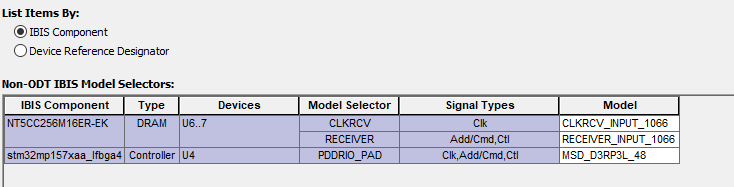

gokhannsahin
How did you identify them? If I change parameters in CubeMX, do I need to change them too?
Also, when ODT is disabled, for DRAM, DQS40_ODT_60_1066 is right?
I attached the config image, is right?

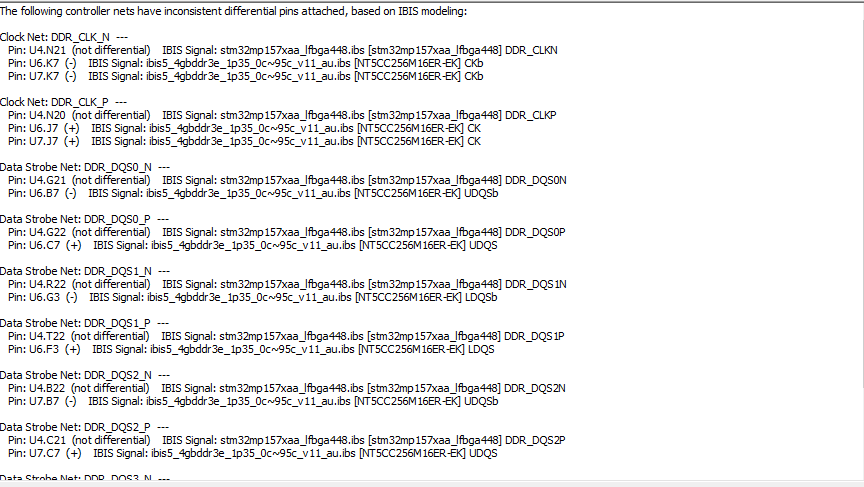

0693W00000D17IgQAJ.png0693W00000D17QoQAJ.pngIf yes, it fails;
0693W00000D17QUQAZ.pngAlso, Hyperlynx gives a warning about MP1 Ibis data.
PatrickF
info in the IBIS file itself,
There are one description for the IO PDDRIO_PAD (for all single ended IOs and CLK/CLK#) and one description for the differential PDIFF_PAD (DQS)

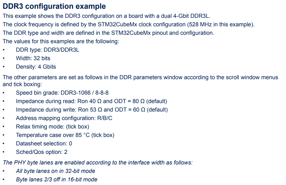

gokhannsahin
Your ref guide gives Ron and ODT the following image, why do we use 60ODT and 48R?
