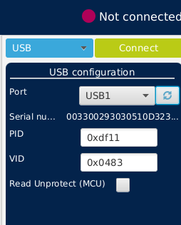

Hi!
I am following the instructions of this wiki page:
https://wiki.st.com/stm32mpu/wiki/Getting_started/STM32MP1_boards/STM32MP157x-DK2/Let%27s_start/Populate_the_target_and_boot_the_image
I have the DK2 connected to my system using the USB OTG port.
The boards dip switches are in the correct position.
I copied the udev rules to /etc/udev/rules.d/.
Pressing "Connect" results in following error:
  16:44:36 : STM32CubeProgrammer API v2.8.0
  16:50:03 : USB speed   : High Speed (480MBit/s)
  16:50:03 : Manuf. ID   : STMicroelectronics
  16:50:03 : Product ID  : DFU in HS Mode @Device ID /0x500, @Revision ID /0x0000
  16:50:03 : SN          : 003300293030510D32313933
  16:50:03 : FW version  : 0x0110
  16:50:03 : Device ID   : 0x0500
  16:50:03 : Error: CUBEPROGRAMMER_ERROR_NOT_SUPPORTED
What am I doing wrong?
Thank you in advance,
Gunther

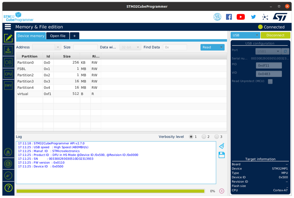

I have more information:
STM32CubeProgrammer-2.7.0 works, but STM32CubeProgrammer-2.8.0 does not.
But 2.7.0 still crashes when ST-LINK is also connected.

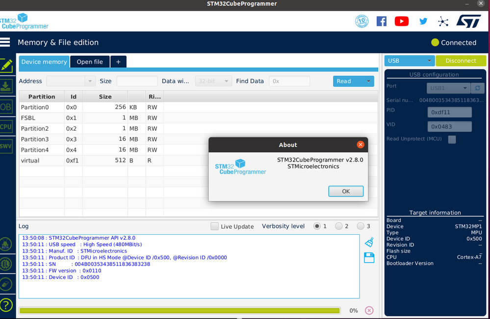

Kevin HUBER
Hello @GLaure​ ,
I recently reinstalled my Ubuntu 20.04 and I encountered the same issue with exactly the same error. And it was also working with the version 2.7.0.
To correct the error, I removed the folder and made again the installation. I had surely made a manipulation error
rm -rf ~/STM32MPU_workspace/STM32MPU-Tools/STM32CubeProgrammer-2.8.0/
Extract again the zip file of the STM32CubeProgrammer-2.8.0
unzip en.stm32cubeprg-lin_v2-8-0_v2.8.0.zip
Start the setup script:
./SetupSTM32CubeProgrammer-2.8.0.linux
Run the binary:
./STM32CubeProgrammer &
Please can you remove and install again your STM32CubeProgrammer-2.8.0 and tell me how it is behaving?
We will investigate the STLink issue later if you still have this problem.
Thanks,
Regards,
Kévin
Edit: A sentence was missing

Kevin HUBER
Hi @GLaure​ ,
Thank you for your help on this issue.
You are right, I was able to reproduce the problem on my Ubuntu. I even reproduced the crash related to ST-link if I run the STM32CubeProgrammer  from the folder just before bin, the folder STM32CubeProgrammer-2.8.0.
I will make a ticket to our developer team to talk about this problem.
