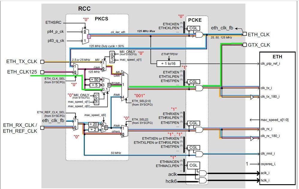

RGMII PHY connection doesn't come up 1000Mbps only 100Mbps
tzsolt
I use a STM32MP157C and connected to MAX24287 PHY by RGMII.
After linux booted there is only 100Mbps connection - I put the PHY into Diagnostic Loopback Mode and the situation is the same.
My dts:
&ethernet0{
pinctrl-names = "default", "sleep";
pinctrl-0 = <&eth1_pins_mx>;
pinctrl-1 = <&eth1_sleep_pins_mx>;
status = "okay";
/* USER CODE BEGIN ethernet0 */
phy-mode = "rgmii-id";
max-speed = <1000>;
phy-handle = <&phy0>;
 mdio0 {
#address-cells = <1>;
#size-cells = <0>;
compatible = "snps,dwmac-mdio";
reset-gpios = <&gpioa 4 GPIO_ACTIVE_LOW>;
reset-delay-us = <10000>;
post-reset-delay-us = <1000>;
phy0: ethernet-phy@3 {
    reg = <3>;
sfp;
/* compatible = "ethernet-phy-ieee802.3-c22"; */
/* interrupt-parent = <&gpioa>; */
/* interrupts = <9 IRQ_TYPE_EDGE_FALLING>; */
/* USER CODE END ethernet0 */
The PHY has 25MHz external clock, it gives 125MHz RX_CLK clock to the MAC, and the MAC would have give 125MHz TX_CLK (as GTX_CLK) to the PHY.
But with auto-negotiation the output on TX_CLK is only 25Mhz as 100Mbps.
This readable in the MAC registers:
devmem 0x50000A10 w 0x10800
devmem 0x50020004
0x00200000
devmem 0x500008FC
0x00000000
devmem 0x50000218
0x01004701
devmem 0x5800a000
0x0807E203
here ought to be 0x08072203 but the mac_speed_o[1] bit is "0" after negotiation.
Operating mode configuration register (ETH_MACCR)
Address offset: 0x0000
Reset value: 0x0000 8000
Bit 15 PS: Port Select
This bit selects the Ethernet line speed.
0: For 1000 Mbps operations
1: For 10 or 100 Mbps operations
In 10 or 100 Mbps operations, this bit, along with Bit 14, selects the exact line speed. In the
10/100 Mbps-only (always 1) or 1000 Mbps-only (always 0) configurations, this bit is readonly (RO) with appropriate value. In default 10/100/1000 Mbps configurations, this bit is readwrite (rw). The mac_speed_o[1] signal reflects the value of this bit.
Debug result from MAC registers:
What could be the bad settings?
I could not have any idea more.
Thank you.

tzsolt
Meanwhile yesterday I set the connection in the device tree for:
fixed-link {
speed = <1000>;
full-duplex;
pause;
and now there is 1Gbps link BUT the data transfer doesn't work:
[    5.789269] stm32-dwmac 5800a000.ethernet eth0: No Safety Features support found
[    5.796938] stm32-dwmac 5800a000.ethernet eth0: IEEE 1588-2008 Advanced Timestamp supported
[    5.805903] stm32-dwmac 5800a000.ethernet eth0: registered PTP clock
[    5.813544] stm32-dwmac 5800a000.ethernet eth0: configuring for fixed/rgmii link mode
[    5.820435] stm32-dwmac 5800a000.ethernet eth0: Link is Up - 1Gbps/Full - flow control rx/tx
the ping command doesn't work either!
Maybe could it be the cause of the not working auto-negotiation:
"does not report in-band status for link state, clock speed and duplexduring normal inter-frame" - I read in the MAX24287 (PHY) datasheet...?
Regards: Zsolt

OlivierK
Hi tzsolt  (Community Member)
Did you manage to progress on this issue?
fixed-linked is indeed used when mdio is not present to manage the phy.
The particularity of this device (Max24287) is that it is a parallel to serial interface between the Phy (SFP in your case) and the MAC so both sides need to be checked. I scanned through the Max24287 specifications, on the serial side, did you check the autonegociation in 1000 base x went well?
System software can configure the MAX24287 for 1000BASE-X auto-negotiation by setting PCSCR.BASEX=1 and BMCR.AN_EN=1.
Are you able to read those using the mdio bus?
tzsolt
Unfortunatelly no progress...
Yes, I could read all of the registers and PCSCR.BASEX=1 and BMCR.AN_EN=1 are correct.
Meanwhile I figured out that there is one driver wrote by a guy but it is based on linux kernel 2.6 and now I downloaded 5.10.61 from ST.
We could not port it to 5.10...
