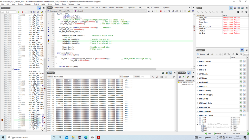

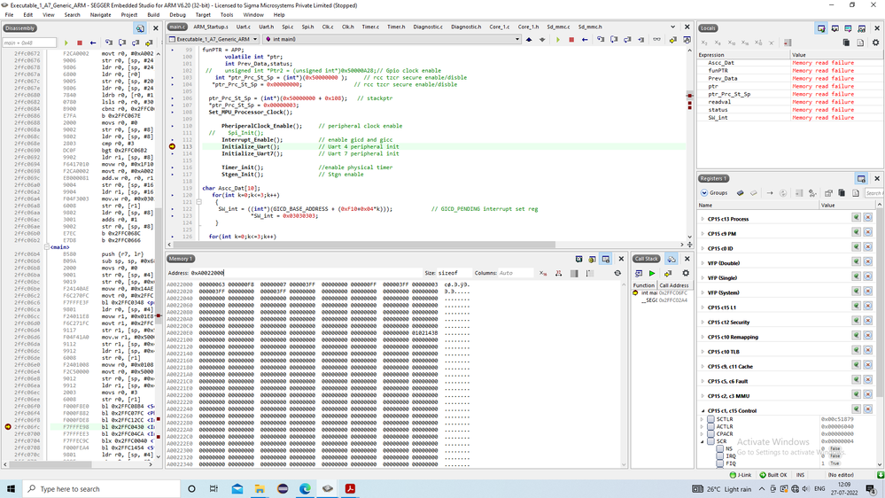

I am using Cortex A7 processor GIC V2 for Interrupt handling. I configured GICC and GICD both. I enabled timer and interrupt for timer also. After enabling timer i can able to see pending status in GICD but It is not routing to A7 core. For this what may be the reason?

0693W00000QMMuJQAX.png0693W00000QMMu4QAH.png0693W00000QMMtpQAH.pngHi,
Thanks for the reply.
Did you correctly set the GICD_ITARGETSRx ?
we are setting 0x01010101 values in GICD_ITARGETSRx.
Did you tried with SGI (using GICD_SGIR) ?
yes I tried software interrupt is working fine.
You can see the values for GICD and GICC registers in below attachments.

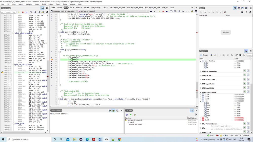

Now i am getting timer2 global interrupt. I am unable to get UART4 Receive Interrupt. I am getting pending status in GICD But it is not going to IRQ handler. For this what may be the reason.
Check GICInterface->PMR register, THis value should be greaer then prority of interrupt.
Bay the way, each core has own GICInterface->PMR and GICDistributor->IPRIORITYR
just for your information, ARM cmsis_5 provide wrappers for CP15 and GIC registers,
I have checked priority registers. I kept same priority for SGI and timers It's working fine. I can able to see Pending status in GICD for UART. But it is not going to IRQ handler.
