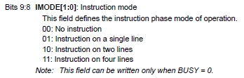

Is it correct for the output to include Command / Address / Data?
I want to output only Data. While I can remove the Address through settings, I couldn't remove the Command.
Is it possible to output only Data?

QUADSPI is build to interface external Flash or similar.
For you concern, did you try playing with IMODE setting ?
