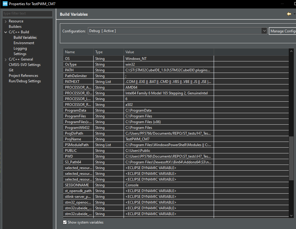

First good fact: following your suggestions and exploring a little bit more the environment i found a list containing a lot of environment variables.
0693W00000QKHJsQAP.pngOpening the Project properties -> C/C++ -> Build Variables and checking the voice "Show system variables", will display a comprehensive variable list...

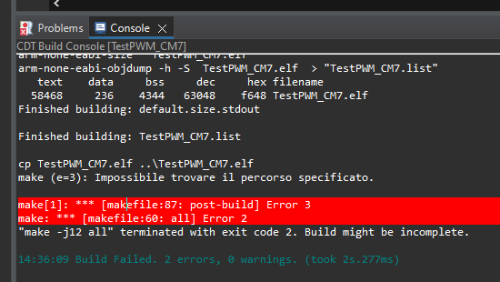

The problem now is that building fails beause makefile seems "Unable to find specified path"
I tried following exactly your example, giving manually full paths and also using environment variables; but the result is always the same.
What I understand watching the console is that now file and paths are correctly expanded in the post-build step, but command fails for some reason.
 Could be a "/" vs "\" issue...

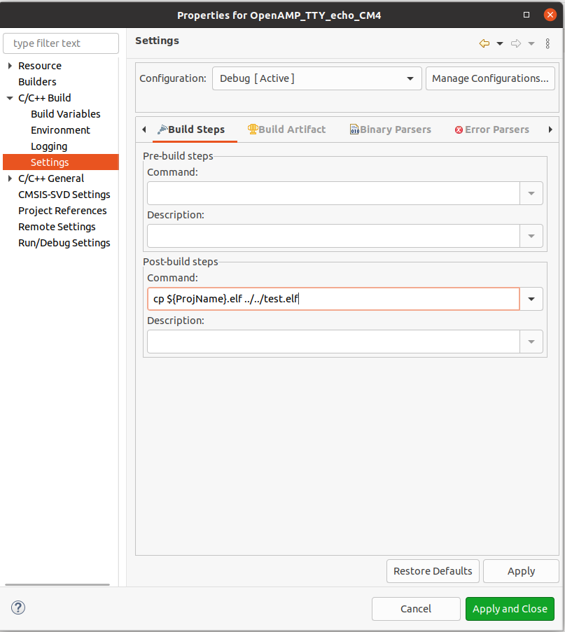

I made a quick test with STM32CubeIde 1.10 and ${ProjName} seems available in post build step:
After the build, the copy is done as expected:
If you still can't access to this variable, you can try to configure a build variable in the property of your project and you set its value to ${ProjName}:
From what I remember, the variable {ProjName} is related to
	<name>OpenAMP_TTY_echo_CM4</name>
inside your ".project".
If it still doesn't work please share some codes with us :)
Hope it helps,
Kevin

Did you success to execute the cp command?
In linux you have to use "/" and in windows "\".
On which OS are you trying to use the CubeIde? Do you still need help?

Coming back at work, I re-started experimeenting on ST platform and after some attempts I fixed my issues!
Well, as you suggested above, there was a path syntax issue: since I'm on a Windows system, I expressed paths using "\"; but it seems that make commands shall be written using linux-like syntax (using "/")!
Therefore your first suggestion was right without "tranlation" to the Windows syntax!
It was so simple! :grinning_face_with_sweat:
