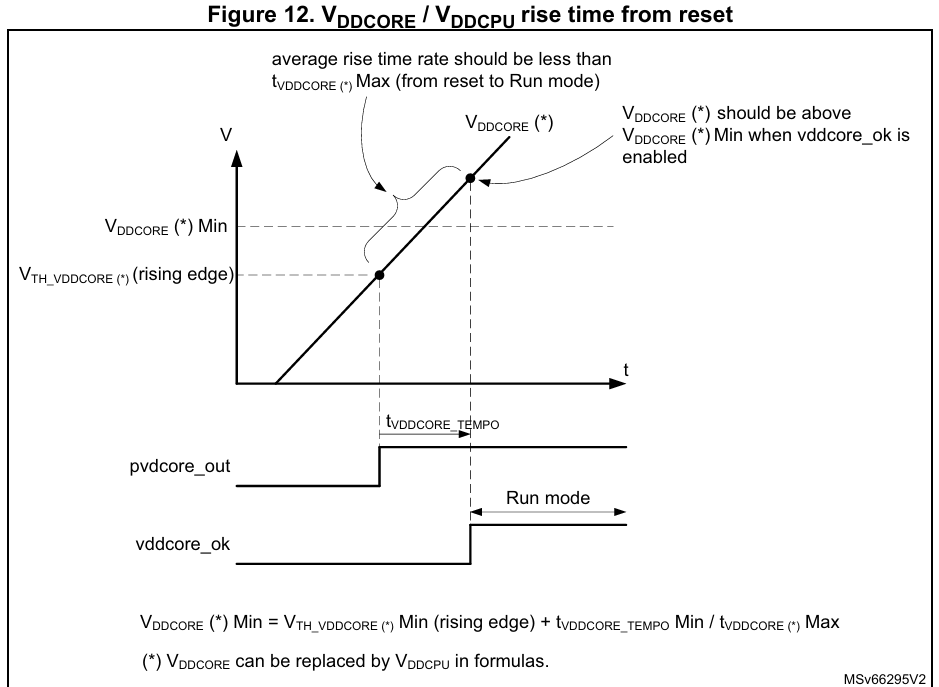

For the STM32MP135 series, specifically the STPMIC1A I'm using, can VDD_CORE and VDD_CPU share the same power rail (buck1)?Snipaste_2026-03-26_15-13-28.png

HI @LH1
you could probably find some answers in following documents:
