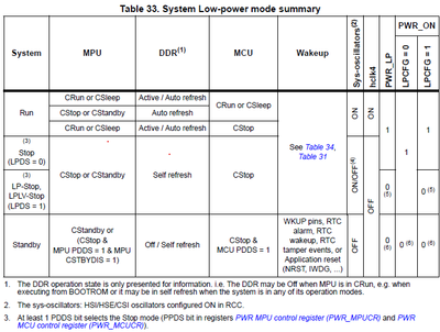

sorry, I was not precise enough. Yes, in addition to WUP pins, RTC (regular or alarm) and TAMP (tamper detection) and reset could wakeup from STANBDY.
This is listed in Reference Manual (abstract below):
Regarding "echo mem > /sys/power/state", I'm not SW expert, but my understanding is that lowest achieved low power mode depend on enabled wake up sources in Linux. Details are available in wiki and application notes.

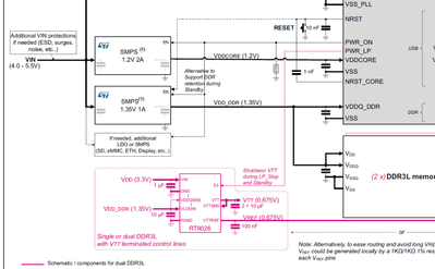

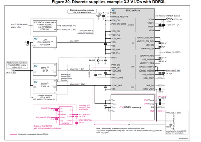

Thank Patrick, we are working within team, and this is a serious project.
We don't need power off but we need low power and wakeup by RTC. We changed our hw design to work with PWR_ON.
We are using single DDR3L, as picture below, can we leave PWR_LP unconnected?
