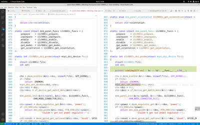

static int stm_drm_platform_probe(struct platform_device *pdev)
	struct device *dev = &pdev->dev;
	struct drm_device *ddev;
	int ret;
	DRM_INFO("Simple example - %s\n", __func__);
	return 0;

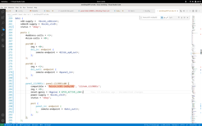

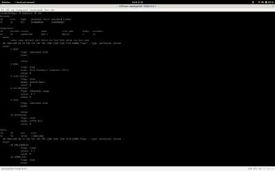

Thanks, I have solved this problem, it was because I used the wrong device tree configuration, now I upload my device tree and panel-ilitek-ili9881c.c so that others can see it in the future.
I don't connect a real panel, so it is always timeout.

By default, the software delivered for the STM32MP257F-EV1 board is set to be used with a specific LVDS panel. You can see its configuration in the kernel board device tree : stm32mp257f-ev1.dts
In this device tree, you can see 2 nodes that can interest you :
  • lvds node : status = "okay"
  • dsi node : status = "disabled"
The thing is that the DRM driver will be able to load if the complete graphic drivers chain is able to probe. In your case, if you use a MIPI DSI panel, but the driver is not configured or probed, you will fall on a such issue.
In summary :
  1. Check that your device tree enable the DSI node, with a correct configuration for your panel.
  2. Check that your panel driver (specific or generic driver) is well probed.
  3. Check the new status
	int ret;
	return 0;

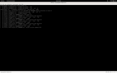

So now back to my question, I think this function should run here when kernel trying to mount the display module, but in reality it does not, so how the kernel can reach here(ili9881c_dsi_probe)? I think there is no problem with the device tree, and this display can also be found in the kernel log.
CONFIG_DRM_PANEL_ILITEK_ILI9881C=y
root@stm32mp2:~# dmesg | grep ili98
[    0.315353] platform 48000000.dsi: Fixed dependency cycle(s) with /soc@0/rifsc@42080000/dsi@48000000/ports/panel-ili9881c@0
root@stm32mp2:~# ls /dev/dri/ -a
Hello @mteaching ,
What I wanted to say is that the modetest command will work only if the complete graphic driver chain is well probed, with our panel or with your own one anyway.
In your case, I think you have probe issue for your panel that you need to solve first.
Can you share your complete boot logs here (dmesg) here ?
By the way, you can also activate drm dynamic debug to get some additional information. To do it, you need to add the following in your kernel bootcmd : loglevel=8 drm.debug=0x1ff

Hello, Erwan:
the hardware design is in progress.
