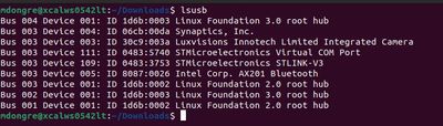

I'm working on an ISP tuning project for an IMX219 sensor on an STM32MP257F-DK board, using the X-LINUX-ISP package and the ISP IQTune tool.
I am facing some errors like

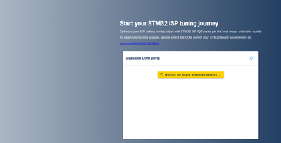

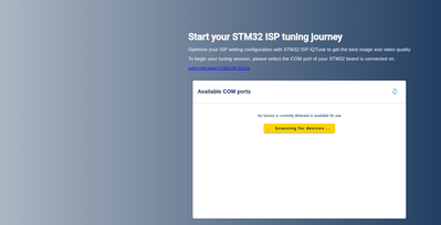

1. The COM port is not getting detected in the ISP IQTune tool and giving error as
Waiting for board detection service

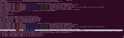

2. Also when I run the python code from x-linux-isp tool it is giving a resolution error
The board is recognized by my laptop using acm command and lsusb but it is not coming in the application.

Hii Gregory,
Yes I am following the same steps from the wiki page. I have started the camera preview from the board and then trying to get it discovered in the ISP IQTune app for Linux, but it is not getting detected. Also when I run the camera preview from the board then it gives me error for resolution.
The only difference I found is I am using imx219 whereas the procedure is given for imx335.
So to use imx219, do I need to do some steps to configure it for tuning?
Or is there any other issue or changes that have to be done for the same?
