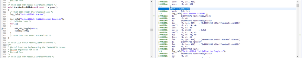

Inserting Breakpoint after Execution hangs when initializing Mutex or Semaphore in FreeRTOS
victor.b
I am using the STM32MP157C-DK2 and so far i manged to make FREERTOS work flawlessly with OpenAMP and the tracing printf functions. I can insert breakpoint at any point without a problem. However, i start having issues when i declare a semaphore or a mutex in the function MX_FREERTOS_Init().

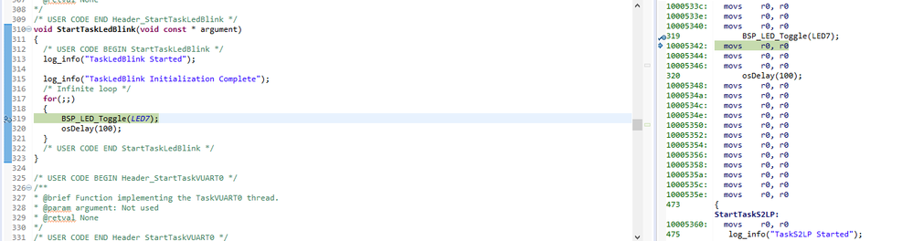

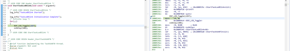

could you please precise if you are using SW4STM32 (i.e. GDB/OpenOCD debug) or another debugger ?
There is a separate thread which sound similar : https://community.st.com/s/question/0D50X0000B422in/stm32mp1-freertos-debug-issue

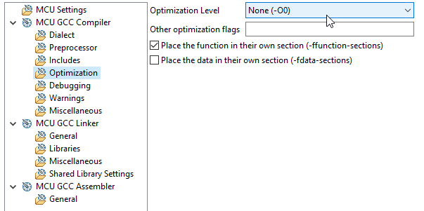

Is reducing the optimization level solve your issue ?
Seems linked to the way GDB manage the debug and the way FreeRTOS manage the stack pointers.

Here is some images showing what i am experiencing:
This image shows what i see when I initialize the mutex (but do not use it, as seen in the app_freertos.c file in the previous post) and i am stepping inside the function MX_FREERTOS_Init before the scheduler is called. We can see that i placed a break point inside the Led blink task and that the dissasembly seems ok for that part of the code:
Then, when i hit the "resume", it hits the breakpoint and the disassembly seems ok. But when i press resume again, it should hit back the same break point 100ms later...but it hangs there and its over.
The board is now bricked and has to be reset before i can launch a new debug session. Here in this last image, i launch the debug session with no breakpoint. The code is running fine (the led is blinking), but when i place a breakpoint at the same place, i get a weird disassembly. Also i cannot "resume" because it hangs there.
I tried declaring the mutex/semaphone, and delete them immediately after, and it does the same thing. The only wait to be able to debug with break points is to not initialize any semaphone or mutex.

victor.b
Hi Patrick,
I am using SW4STM32 and it looks like it works when i remove the option "optimize for debugging" and set it to "None":
I will move foward and see if it still works when i start using the declared mutex and semaphore.
Thanks!
victor.b
Ok so here is the sad part:
When i use "None" in Optimization level, OpenAMP works erratically and end up crashing!
