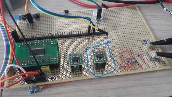

i'm developing firmware for STM32MP135F-DK board to communicate with some external chips in I2C1.
No problems if I communicate with other I2C chips (clockgen, eeprom, io expander).
Communicating with the RTC PCF85063 chip happens that no problems if I send write command.
If I send a read registry command the I2C bus stucks with the SCL and SCK lines at low level. And the bus stays locked until MP135 reset. If i only power down, than power up, the PCF chip, the SDA line goes up but the SCL line stays low so again i2c locked.
I attached the scope screeshot: in particular I see the initial write/set current register acknoledged; when I send the read command I see the read packet with the chip address (0x51+1 bit high for read) but it is never acknoledged cause the lines levels..
The problem is always present even I change the register to read.
For each kind of communication I'0m using the HAL_I2C_* functions.
Any idea?

Hi @PatrickF
yes i checked it via CLKOUT pin as you can see in the image.
Thanks, regards

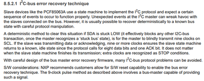

have you tryed this suggestion from the datasheet?
seems like that is what you may be facing.
hope it helps.
greetings
Hi @urbito,
yes, I saw the note but I'm not yet be able to apply it, and then reset the chip.

is it possible to you to share your PCF85063A schematic?
The schematic is very basic: so far, we have only a hand-wired board.
The communications with other chips are ok, on the same I2C bus.
The RTC chip on the board does not have the backup battery and capacitors.
I tested the reset procedure as stated on the datasheet.
If I run it without the RTC chip I see the (manual) clock I generate by code.
If I run it with the RTC chip and I fire the read command I have the problem: both SCL  and SDA pin low. If I run the reset code I see nothing (SCL always low). If I power off the RTC chip only the SDA pin returns high. The SCL stays low.
So, is it the RTC chip that lowers the SCL pin or the MP135 chip ???
SteMMo
Senior
I'm very sorry.
I've just discovered that the RTC chip owns the same I2C address of the STM32G071 chip present on the 135DK demo board = 0x51 !!
(crying)
Still wondering why the clock stops ..
