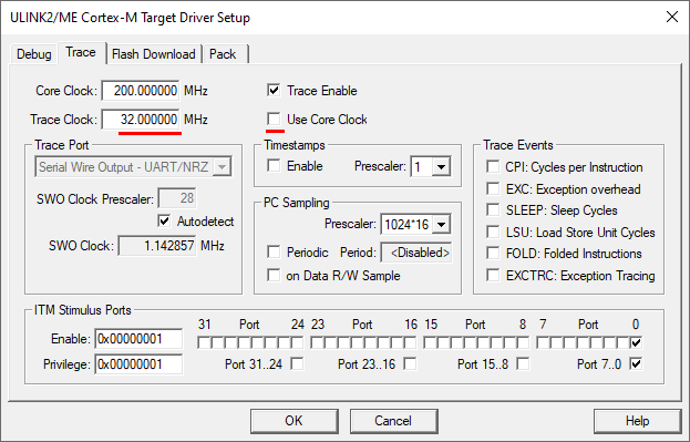

My question is more low level. How do I configure the trace funnel and associated ITM debug registers to route the M4 SWO function to the physical SWO pin? I want to use SWO also under Engineering Mode boot.

I was able to figure it out. It is much simpler than I thought since the CM4 ITM is directly connected to SWO, and SWO automatically muxes the CM7 (APB Mux) and CM4 inputs. In the end, the main issue was understanding the clock gating.
All I needed to do to enable the CM4 ITM output via SWO was enable the trace clock:
// 1) Enable Trace Clock (use default divider, TRACEDIV = 1)
RCC->DBGCFGR |= RCC_DBGCFGR_TRACECKEN;
After that, I just needed to give Keil the correct trace clock speed. Trace clock comes from AXI clock, which I currently have set to 64 MHz HSI. With the default TRACEDIV = 1, the trace clock is thus 64 MHz / 2 = 32 MHz. Further, Keil seems to take care of the SWO registers (SWO_CODR and SWO_SPPR) automatically, so I found there is no need to set them manually in firmware.
I did not realize that the ITM (mcu_ss_ck) and SWO (sck_sys_dbg) are clocked separately and that the Trace Funnel is only used for the TPIU output on the STM32MP1 series. Fortunately the Reference Manual for the STM32MP1 had all the information I needed...I just need to dig through it and do some trial and error.
