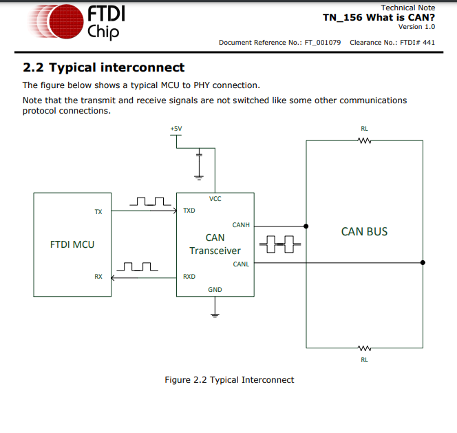

2023-03-21 8:46 AM
When working with a CAN transceiver and and MCPU you do not cross TX/RX. It may appear to work, but it will fail as the CAN network grows and there are multiple senders/receivers.
2023-03-21 8:53 AM
Yes you're right! Thanks
