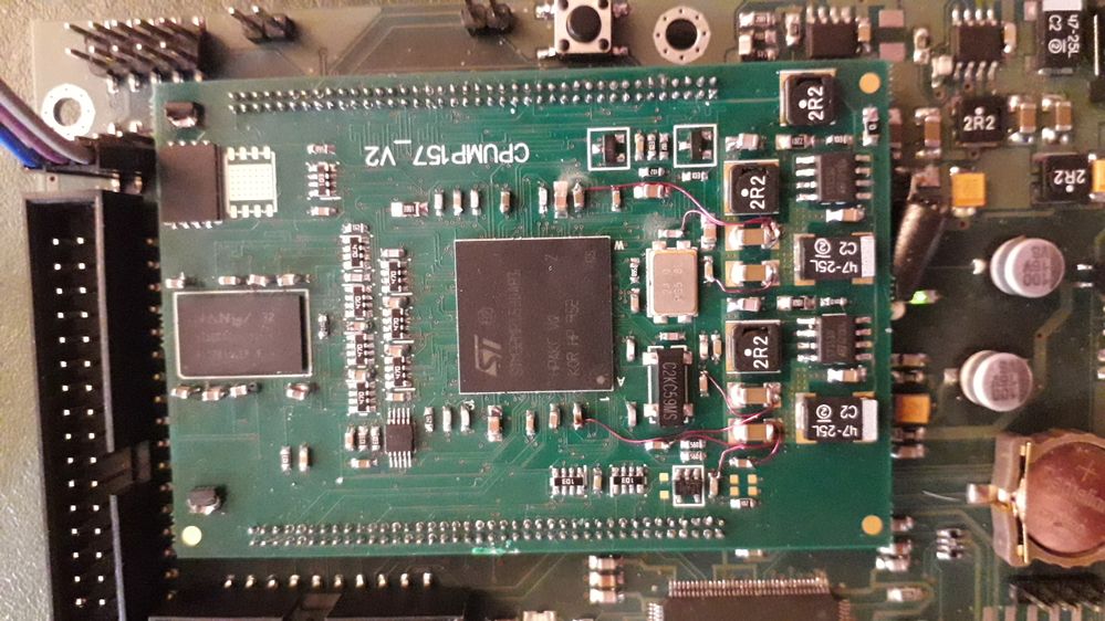

0693W000003Qj3lQAC.jpgYou can done this task by using USB_OTG based stack from STM32H7 CPUs.
STM32MP1 hardware very similar in this case.
I am use in my project this codebase, For access to USB_HS2 port you need initialize USBPHYC peripheral.
All of these (including DDR3 and TZC initialization) you can find at my repo here: https://github.com/ua1arn/hftrx
Note! Use branch "develop". In stm32mp1 target I use only A7 core.
