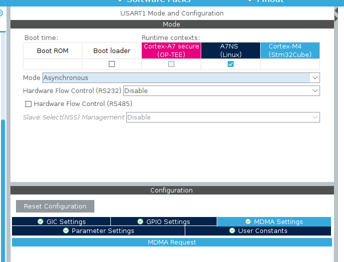

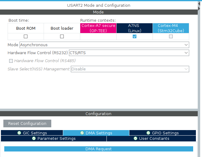

Hello @vbuon.1​ ,
I can see two problems in your DTS configuration:
MDMA and not DMA
USART1 is not linked to the DMA, but it is connected to MDMA
You can see that by using CubeMX, for USART1 only a tab MDMA Settings is available:0693W00000Nr676QAB.png
When for the other USART like USART2, you can see a DMA Settings tab:
This information is also wrote in the refman (RM0436.pdf) table 98 page 1158: https://wiki.st.com/stm32mpu/wiki/STM32MP15_resources_-_v3.1.0
Where the USART1 is only in the MDMA table, but not in the DMAMUX table at the page 1224.
DMA Request MUX Input
Regarding your dmamux configuration, we can see in the same table page 1224, that the MUXs that you try to request are the one for USART6
As explained above, USART1 is not connected to the dmamux.
If you look at the file "stm32mp151.dtsi" you can see an example with SPI6 of how to configure the MDMA and you have to use the mux 32 and 33
