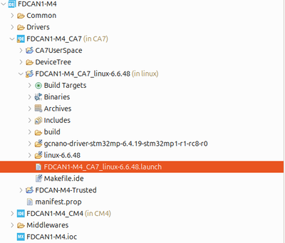

I created an STM project of the STM32MP157f-dk2 in eclipse.
I've tried to build the entire A7 core linux code. How do I replace what's on the dk2 now? The dk2 just has the starter package on it.

I noticed that when I build the linux kernel, the output goes to:
 gcnano-driver-stm32mp-6.4.19-stm32mp1-r1-rc8-r0 -> STM32MPU-Ecosystem-v6.0.0/Developer-Package/stm32mp1-openstlinux-6.6-yocto-scarthgap-mpu-v24.11.06/sources/arm-ostl-linux-gnueabi/gcnano-driver-stm32mp-6.4.19-stm32mp1-r1-rc8-r0
linux-6.6.48 -> STM32MPU-Ecosystem-v6.0.0/Developer-Package/stm32mp1-openstlinux-6.6-yocto-scarthgap-mpu-v24.11.06/sources/arm-ostl-linux-gnueabi/linux-stm32mp-6.6.48-stm32mp-r1-r0/linux-6.6.48
Makefile.ide -> STM32MPU-Ecosystem-v6.0.0/Developer-Package/stm32mp1-openstlinux-6.6-yocto-scarthgap-mpu-v24.11.06/sources/arm-ostl-linux-gnueabi/linux-stm32mp-6.6.48-stm32mp-r1-r0/linux-6.6.48/../Makefile.ide
 I try following the same steps as building and copying linux kernel.
When it comes to the following step:
find ${OUTPUT_BUILD_DIR}/arch/${ARCH}/boot/dts/ -name 'st*.dtb' -exec cp '{}' ${OUTPUT_BUILD_DIR}/install_artifact/boot/ \;
there are not any `dtb` files.
most likely you built into source directory. have a look into linux-6.6.48/arch/arm64/boot/dts
