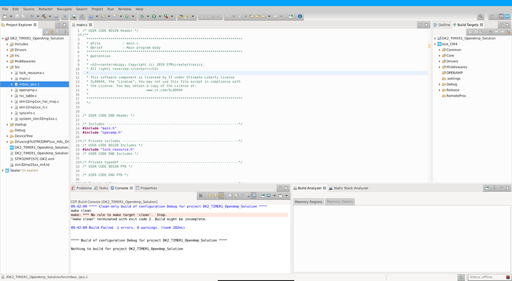

When I hit the build button, I get "Nothing to build for project DK2_TIMER1_OpenAmp_Solution", the Debug folder is also empty, should this be populated or do I need to generate it somehow?

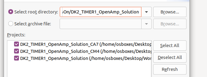

  • Go inside the folder "InputLabMaterial/Lab-M4" and unzip STM32Cube_FW_MP1_handsOn.zip

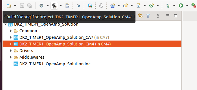

  • Finally, if you import the project in CubeIde 1.8.0, you will see 3 projects:
0693W00000JPvJ1QAL.pngClick on finish and select "DK2_TIMER1_OpenAmp_Solution_CM4" in the project explorer and click on the build icon (hammer):
You must be able to build the project.

Hello @msche.1​ ,
I assume that you followed the step from the video.
Please can you send me a screenshot of your project explorer on the left side of CubeIde and the complete log from the CubeIde Console when you hit the hammer (build button).
Regards,
Kevin
NEW ! Sidekick STM32 AI agent, see here
Yes, I followed the steps. Basically just unzipped, imported and built.
