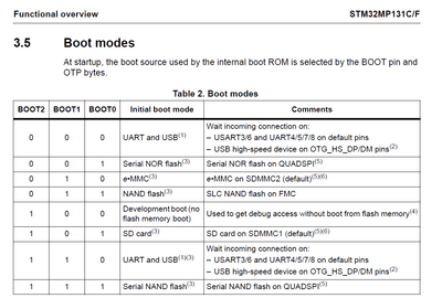

What does it mean that it does not support QSPI flash memory?
If so, what is the "Serial NOR Flash on QSPI" mentioned in the Boot Mode section of the STM32MP131 Datasheet?
Hello @Stnoobs ,
Yes the MP13, from an HW point of view can support it, and in SW this is the case on Linux side. But for MP13 Bare metal, drivers are not present.

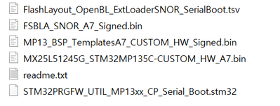

According to the readme.txt file, the source code of the bin file shown in the picture below is said to be requested to ST.
Can I get the code?
