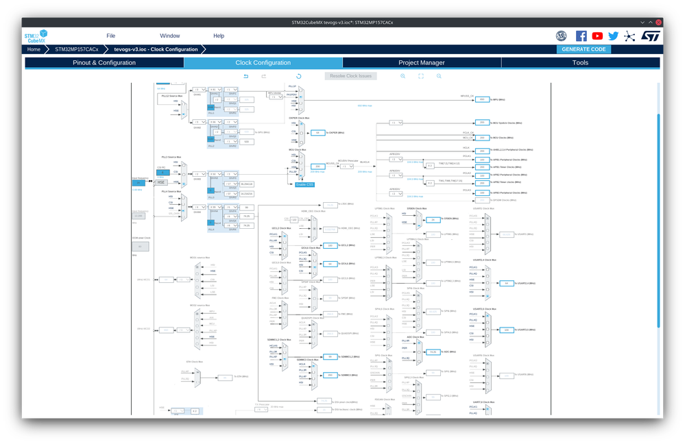

as for using DDR50, the driver need to use at least a divider by 2 inside SDMMC, IP need to get 100MHz from the RCC. Maybe adapt your PLL post divider or SDMMC clock source.
Don't know if this would be enough to get DDR50 working, but it is a prerequisite.

Our clock tree is configured like this:0693W00000DqRGbQAN.pngI think this should be correct. Isn't it? Should I alter the SDMMC clock source? Can you guide me if so, please?
