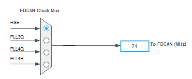

I am using a STM32MP157C-DK2 board to communicate via CAN. To do this, I have created a program in STM32CubeIDE and set the FDCAN parameters:
  • Classic mode.
  • 150KB/s nominal baud rate.
  • HSE clock source (24MH)
I have been testing in engineering mode and I was able to receive and send CAN messages (I have connected to an IXXAT device).

In order to change the clocks, do I have to create my own machine?
I have checked the clocks with the command "cat /sys/kernel/debug/clk/clk_summary" and I have seen that the configuration is not the same as the one I have designed in the STM32CubeIDE:
  • "cat /sys/kernel/debug/clk/clk_summary" shows the following:
 clock                        enable_cnt prepare_cnt       rate  accuracy  phase
clk-hse                                 1           1   24000000         0 0
  ck_hse                               7           7   24000000         0 0
     ck_hse_rtc                        0           0    1000000         0 0
     stgen_k                           1           1   24000000         0 0
     usbphy_k                          1           1   24000000         0 0
     ck_per                            1           1   24000000         0 0
        adc12_k                        1           1   24000000         0 0
     ref4                              1           1   24000000         0 0
        pll4                           1           1  594000000         0 0
           pll4_r                      0           0   74250000         0 0
           pll4_q                      1           1   31263158         0 0
              ltdc_px                  1           1   31263158         0 0
              dsi_px                   0           0   31263158         0 0
              fdcan_k                  0           0   31263158         0 0
  • In my desing the FDCAN clock is connected to HSE as it can be seen above
I'm thinking that maybe the FDCAN clock is not activated when I turn on the board in production mode
Thanks!
