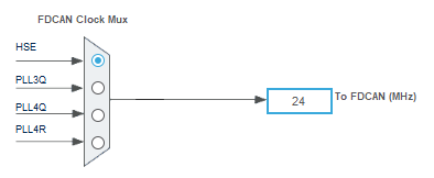

I see that i have to enable the clock. In my case, I have connected the FDCAN1 to HSE as you can see in the image:
0693W00000WKDjRQAX.pngIn the main program, I think I have enable this with the PeriphCommonClock_Config program:
